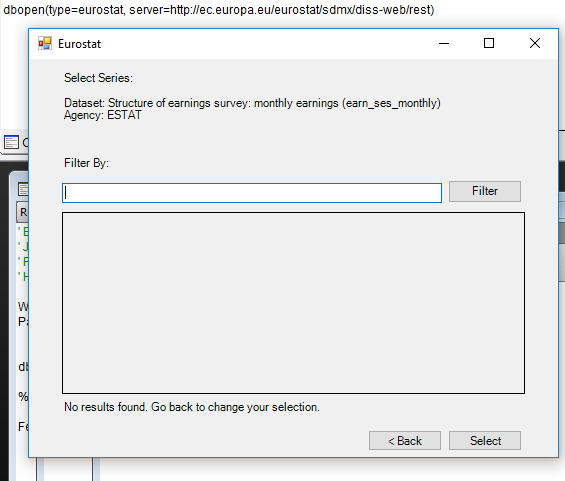

When I browse the Eurostat database via Eviews I find no results, even though the equivalent data can be fund at the Eurostat website.

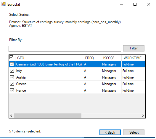

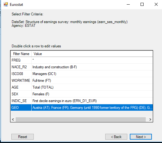

With SDMX databases it is better to limit your search by selecting filter criteria.
As an example these are the filters I selected for the database earn_ses_monthly
The results of these selections will be :
Are there specific filters you selected that failed to give results?

Thanks your filters work. It seems like the filters have to be very specific. As I recall this was not the case about a year ago, but I was browsing through other tables at that time.
It would be nice with a message telling the user to narrow the search criteria, instead of the message 'no results found', if that is possible.
