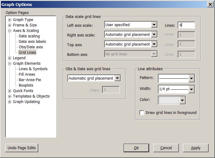

Dear Eviews team,
I use Eviews 11 17 Sept 2019 build.
In a graph with individual panels, setting data axis gridlines manually via the right-click menu does not work properly. (It works using program code, though.)
To document the bug, run the code below and right-click on the graph, select "Options on all graphs", and try to set the number of gridlines to 9
[/code]
The result looks like this:
Best
mamo
wfcreate a 2000 2019 4 series x=80+nrnd*5 freeze(mode=overwrite, gra) x.line(panel=i) gra.axis(l) range(0,100) show gra ' the following line works; 'gra.options gridl(9) ' but not so manually using the right-mouse click menu "Options on all graphs"
