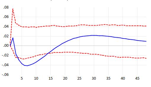

Hi guys,
I have applied the Kilian add-in to a standard monetary VAR to retrieve impulse responses with bootstrapped confidence intervals. For a minority of impulse responses, the mean response exceeds the bootstrapped confidence intervals. To me, this does not make sense. For illustrative purposes, I will attach a picture of an impulse response to a monetary shock that exhibits said pattern.
I would be most grateful to you if you could provide me with possible explanations for this response behavior.
