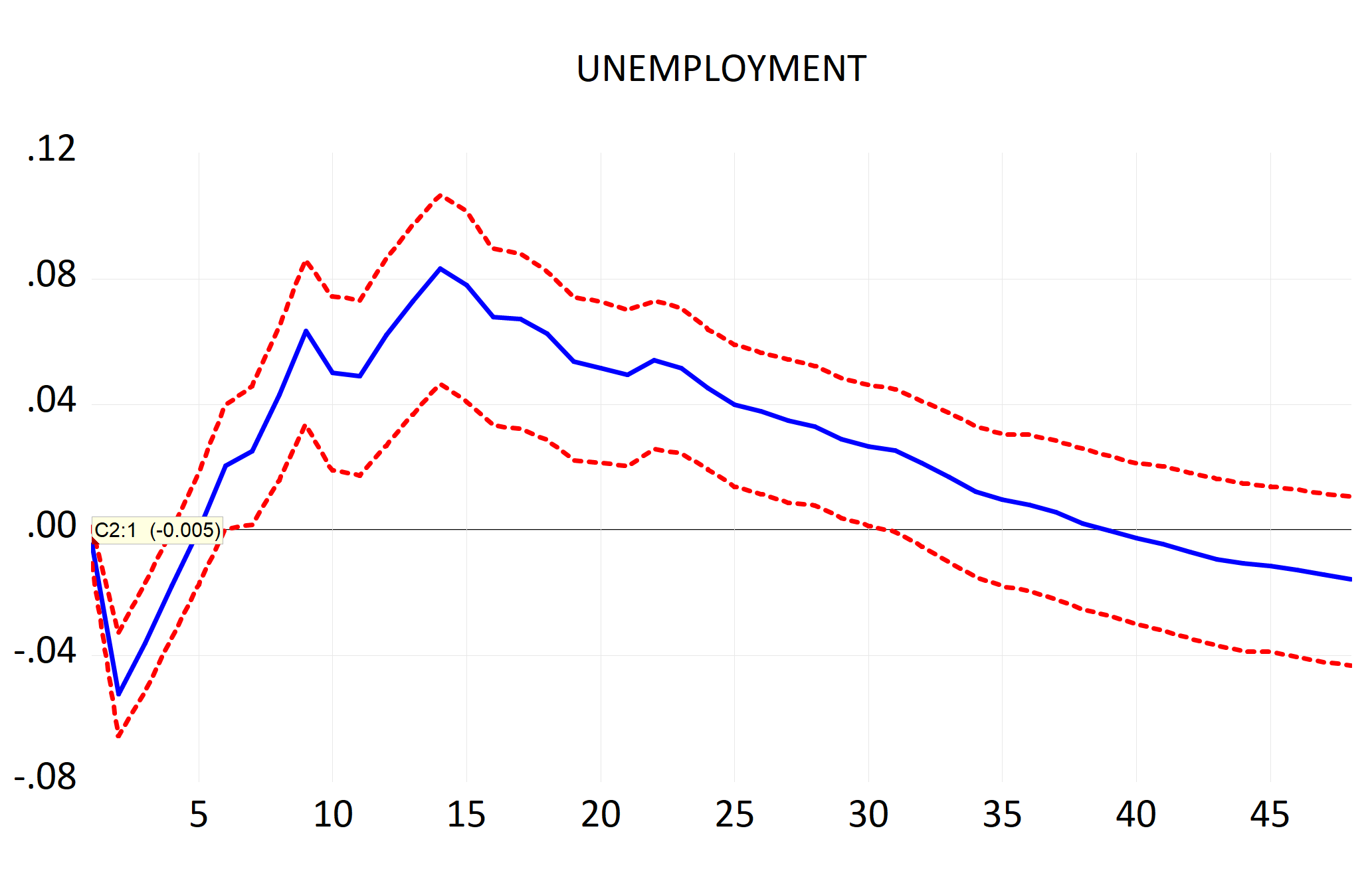

Next, we use this 48x4 IRF matrix (with IRF(1,1)=0; IRF(1,2)=0; IRF(1,3)=0; IRF(1,4)<>0) to calculate the IRFs of selected variables in the large dataset (X_{t} in BBE2005). Therefore, we multiply this matrix with the (transposed) respective loadings matrix (Lambda^{f} and Lambda^{y} in BBE2005, 120x4). The loadings matrix is supposed to have zeros in the 4th column for all slow moving variables as there is no contemporaneous effect of the policy rate shock on those variables. Ultimately, we end up with a 48x120 matrix of the impulse responses of all variables in X_{t}. By definition, the first entry in each column is supposed to be zero for the slow-moving variables and different from zero for the slow moving variables. That is what I meant when I referred to the point that - at least from my point of view - irfs of slow moving variables should always start with zero.
The example file generates an irf matrix where the unemployment rate (slow-moving) starts with an initial value of -0.005 (see appended image). How is this possible? Or do you disagree with my argumentation? I would really appreciate some feedback.
Thank you very much in advance and best regards

Hi Markus,
I think that assumption is questionable. The slow and fast moving variables matter for the factor rotation not for the impulse response functions.

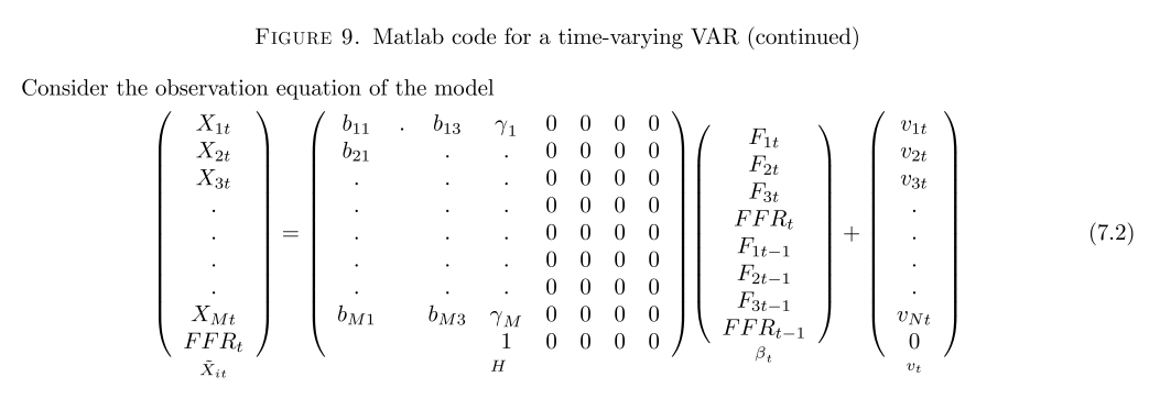

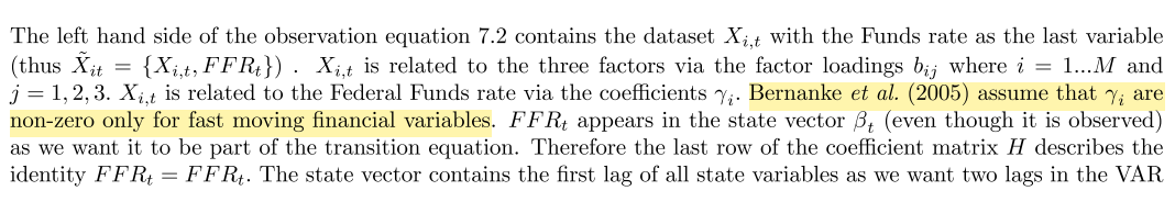

Hi Dakila,
I just came across a handbook by Andrew Blake and Haroon Mumtaz (https://www.bankofengland.co.uk/ccbs/ap ... dated-2017) that supports my argumentation regarding the zeros in the loadings matrix for slow-moving variables:
Observation equation.PNG (50.02 KiB) Viewed 521455 times
This procedure ensures zeros in the fourth column of the loadings matrix.
I hope this enriches our further discussion.
Best regards
Markus
dakila
Posts: 489
Re: FAVAR add-in
Postby dakila » Thu Nov 07, 2019 7:44 pm
If lambda_y equal to zero for the slow-moving variables then you will miss not just the impact period but all period effects of FFR (federal funds rate). That does not make sense.
