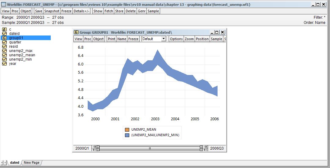

Trying to replicate the Area Band example from User Guide 1.
Using the file: FORECAST_UNEMP.wf1
select GROUP01 - View - Graph - Area Band - OK
produces the attached output.
Best regards
Rasmus
Using Eviews 10, Jun 4 2019 build

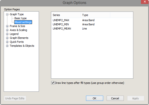

The docs are currently incorrect. With the introduction of the mixed graph type, you must now select View - Graph - Mixed and then select the Mixed settings node on the left, set Unemp2_max, unemp2_min to Area Band and unemp2_mean to line.
mixed graph.png (11.26 KiB) Viewed 9779 times
We will get the docs updated.
