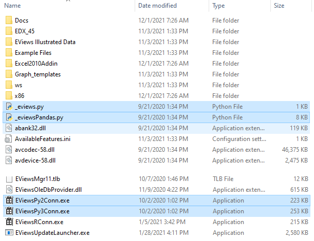

Verify your EViews program folder has the following Python files
Make sure the file sizes match from my screenshot above. If any of these files are missing, re-install EViews 12.

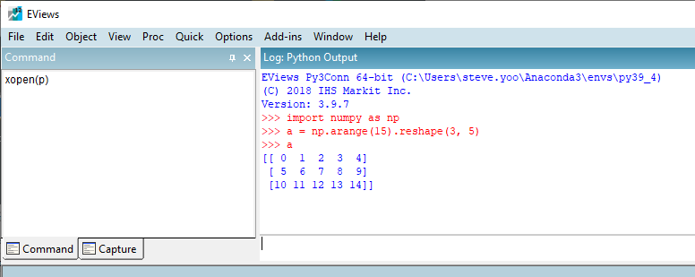

Try Numpy Import Again
At this point, try opening EViews connection to Python and see if you can import numpy successfully.

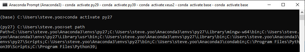

First, you'll have to find out what your PATH setting is when running under your Anaconda Prompt:
1. Run Anaconda Prompt and switch to your preferred Python environment. Once there, run the SET PATH command to display the current PATH string. Here's what it looks in mine (I'm only showing the beginning python related values of my PATH here - yours will be much longer):
You'll notice that my PATH string contains references to both py27 (my selected conda environment) and also Python39. The reason for this is because I have regular Python 3.9 installed on my system. Also notice that the Anaconda 2.7 values are in front of my 3.9 values. Here's the list of Anaconda related path strings without the semi-colons:
C:\Users\steve.yoo\Anaconda3\envs\py27 C:\Users\steve.yoo\Anaconda3\envs\py27\Library\mingw-w64\bin C:\Users\steve.yoo\Anaconda3\envs\py27\Library\usr\bin C:\Users\steve.yoo\Anaconda3\envs\py27\Library\bin C:\Users\steve.yoo\Anaconda3\envs\py27\Scripts C:\Users\steve.yoo\Anaconda3\envs\py27\bin C:\Users\steve.yoo\Anaconda3\condabin
In order to get EViews to work with your Anaconda environment correctly, you'll have to transfer the path values above to your Windows System PATH string directly. One way to do this is to use the Windows Advanced System Properties dialog (update the System PATH value, not the User one).
Once you've updated the Windows System PATH string, call XOPEN(p) again and try the import. It should work this time.
