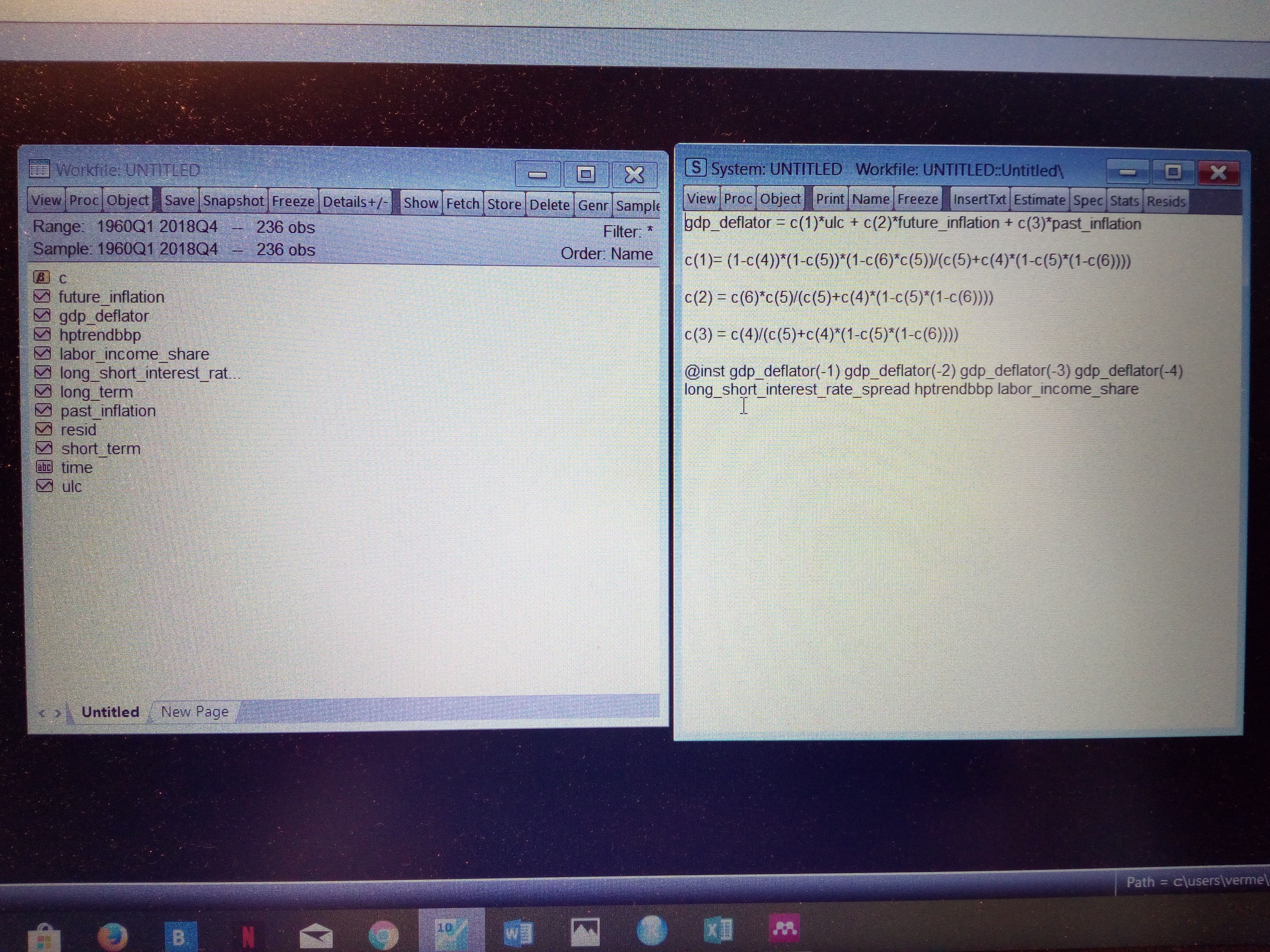

Hello
i'm currently using the student lite version of Eviews so i am not able to export my work.
I have attached a photo of my workfile and the system i use. I hope this will be helpful for you.

Postby EViews Matt » Thu May 02, 2019 11:02 am
I suspect this is a starting values issue (your coefficient object c is probably all zeros, which is creating problems when the coefficients are first used in your system). Randomize the starting coefficients by running the command "rnd(c)" in the command window before attempting the estimation again.
