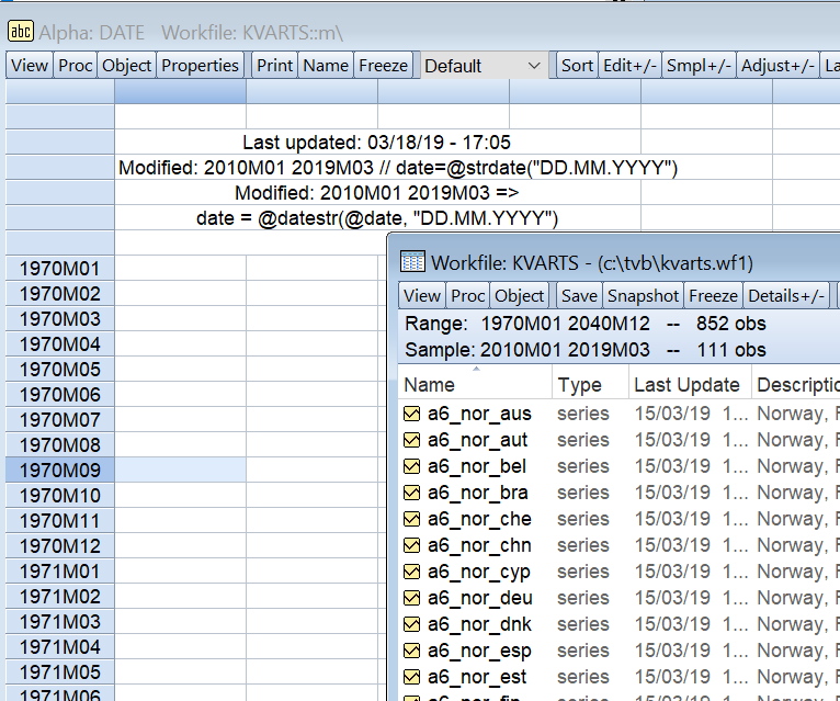

I want to create a string with a date format corresponding to each element in workfile.
The @strdate command works fine on a quarterly page, but I cannot make it work on a weekly or monthly page....?
That is
pageselect q alpha date=@strdate("DD.MM.YYYY")
works, but
pageselect m alpha date=@strdate("DD.MM.YYYY")
or
pageselect w alpha date=@strdate("DD.MM.YYYY")
does not work....
How can I create a string with a date format corresponding to each element in workfile on a weekly or monthly workpage?

Curious, I don't experience a problem with @strdate on a weekly or monthly workfile. Does the following produce the same issue?
alpha date = @datestr(@date, "DD.MM.YYYY")

Postby tvonbrasch » Mon Mar 18, 2019 9:06 am
it does not work either....

Postby EViews Gareth » Mon Mar 18, 2019 9:17 am
Silly question, but you currently have the sample set to 2010 onwards. If you scroll down on the date series, are the dates available from 2010 onwards...?

Postby tvonbrasch » Mon Mar 18, 2019 9:54 am
it is official, i am an idiot.....
