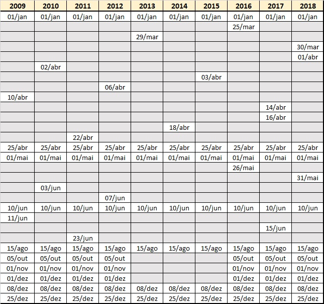

I have an hourly data-set from 01-Jan-2009 to 31-12-2018 (10 years) for Portugal. I need to create a dummy for each holiday day. Do I have to create a dummy for each day, or is there any simpler way to do that?
In the below image you can see every holiday days that were in Portugal from 2009 to 2018.
I thank you all in advance for the help.

I can recommend some commands for creating the dummies. For the annual holidays,
series holiday1 = @holiday("jan1") > 0
For the one-time holidays,
series holiday2 = @event("2016mar25") > 0
For the annual holidays with a gap,
series holiday3 = @holiday("oct5") and (@year <= 2012 or @year >= 2016)
