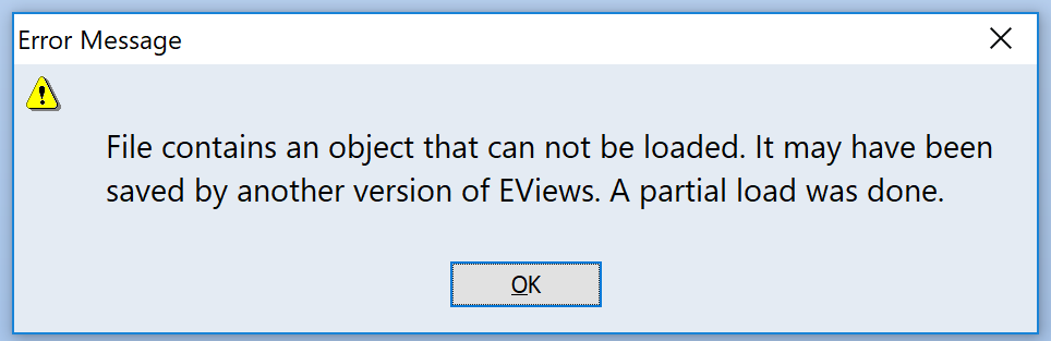

I'm trying to use the protect model feature in EViews 10+ (64-bit, Oct 16 2018 Build), but I'm running into an error. See the attachment below.
I open a workfile, create a model object, protect it with a password, save the workfile, and close. Then I open the workfile and it gives me the error.
Note that I'm working on the same computer and using the exact same version of EViews to both save and open the file.
I'm wondering if this is a bug or if I'm doing something wrong?

We'll investigate. Looks like a bug on first glance.

This is an issue in EV10 that will be fixed in the next patch.

Should be fixed in today's patch.
