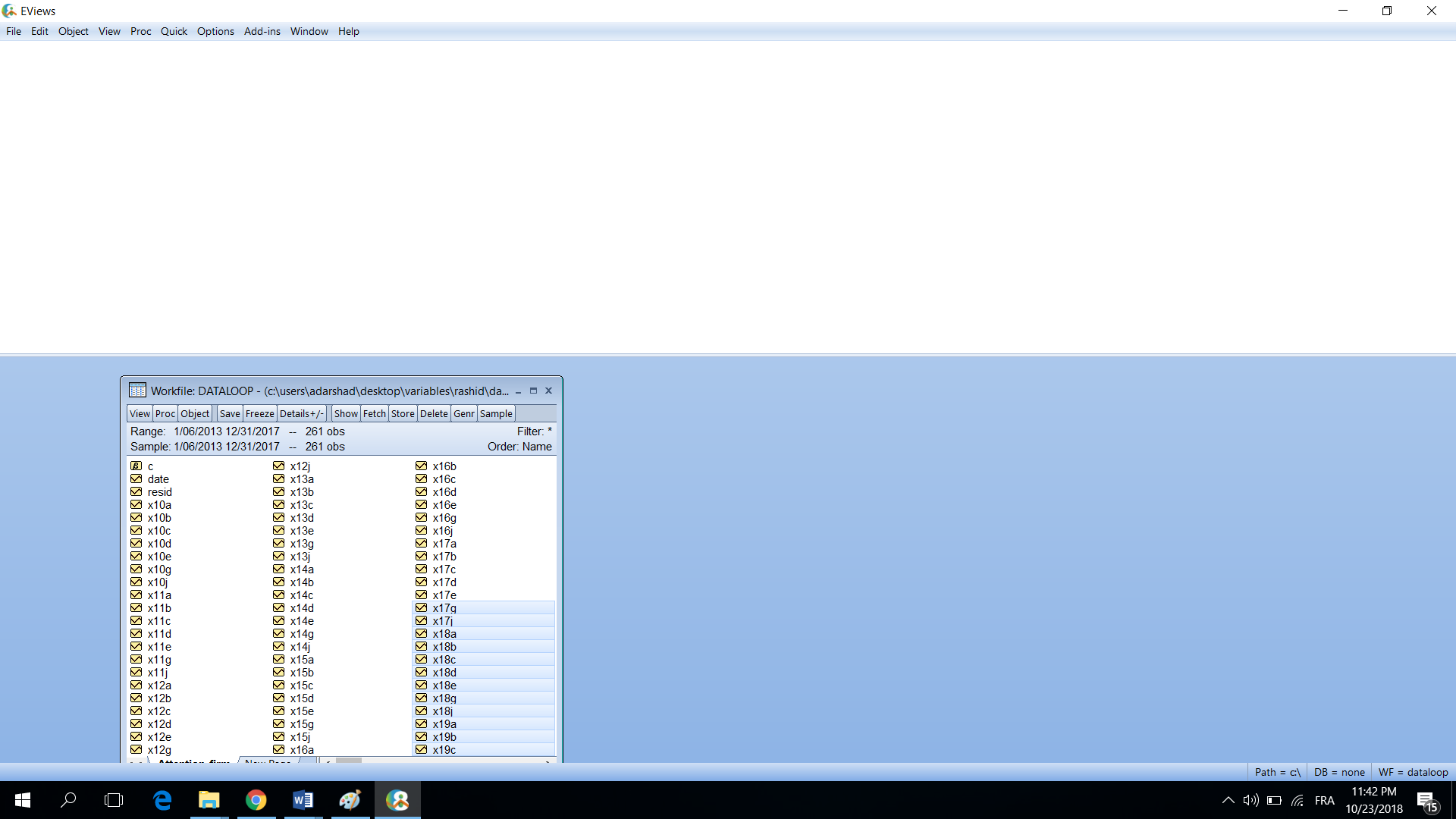

I merely opened your workfile, created a new program, pasted in your code (with the required "next"):
for !i = 1 to 28 equation eq!i.ls y!i x!ia x!ib x!ic x!id c next
Clicked the "Run" button, and the equations were created successfully.

i have tried my code based on your guidance but all the times it doesnot work;i am using eviews8 and i run code in command window but it comes with error.i have my datafile sent to you.i open it and run this code in window but it comes with error;;;as i mentioned;please help me;;i am very near to my finding after long work

what do you mean by created a new program

you mean the upper white space;;you cannot understand the anxiety i feeling

thankyou i got how to run the program ;i wasnot running program in program window and was doing in command window;now i can do it in program window and run and extend my analysis.thankyou for the guidance and persistent help;i was just doomed by my ignorance;now atleast i can try doing my work thanks
