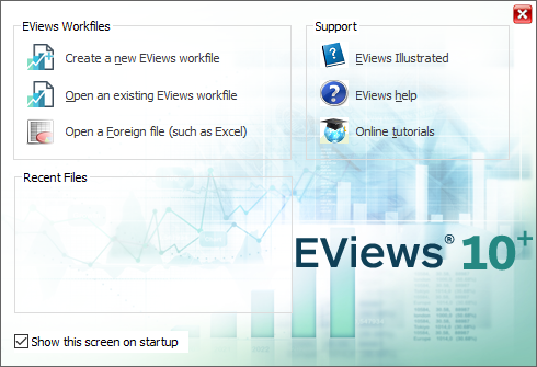

If so, then open the EViews32.ini file using Notepad and search for the Startup Page= line under the [Options] section. If you don't see this line, create it directly under [Options] section header line. Set this value to 0 (e.g. Startup Page=0) to turn off the startup dialog upon startup. Save your changes and then re-open the file to verify your changes were actually saved. Your changes should look something like this:
Now, try launching EViews again. If your changes were preserved, then EViews should now launch without showing this Startup dialog:
If you see this dialog, then something outside of EViews has changed or reverted your EViews32.ini file when you launched EViews. Leaving EViews running, re-open the INI file in Notepad and verify that the file has been reverted and your changes have been lost. If your changes only get lost once a day, you may have to wait until tomorrow in order to verify this.
With this verification and the location of your EViews32.ini file in your EViews distribution, this should be enough information for your EViews admin to change your EViews distribution to prevent this overwrite/deletion.
