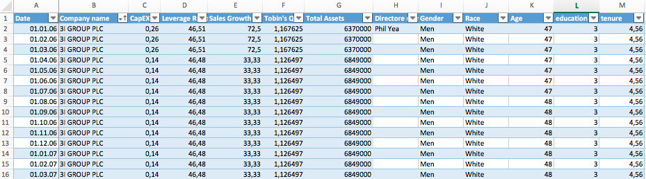

Im not sure, I understand. Do you mean like this? I attached it?
Thank you very much.
Screen Shot 2018-08-27 at 22.41.24.png (132.41 KiB) Viewed 8113 times

What ties a row in one of the workfiles with a row in the other? How are the observations (firms?) connected?

They are connected/tied through the company name. (I'm sorry, I feel so stupid).

You probably want to make two different workfile pages and then link them by company name. A place to get started is http://www.eviews.com/help/helpintro.ht ... cepts.html

Got it!! thank you all.
