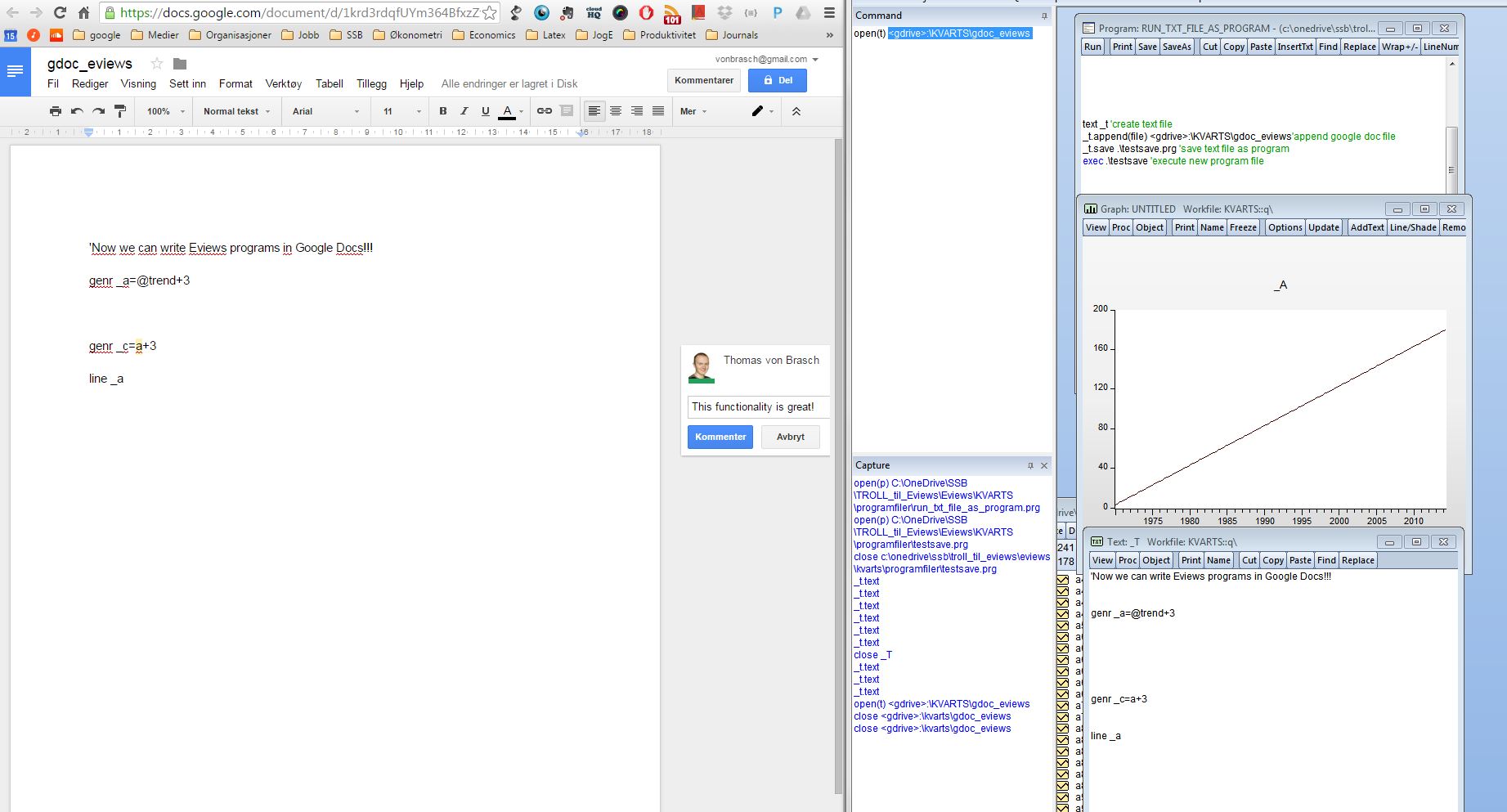

Postby tvonbrasch » Tue Sep 06, 2016 4:37 am
After the last update, it works perfect! Being able to work on program files in Google Docs is great!

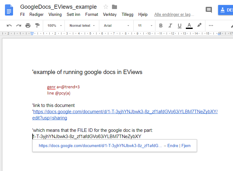

Figured out an alternative way to execute Google Docs as EViews programs. Given a Google Document, such as,
google docs.PNG (31.99 KiB) Viewed 11745 times
use the FILE ID and insert it in the following program
%fileid= "1-T-3yjhYNJbwk3-8z_zf1afdGVo63iYLBM7TNeZybXY" call googledocs(%fileid) 'executes the Google Doc as EViews program '------------------------------------------------------------------------------- subroutine googledocs(string %fileid) %filename = "googledocs_may_be_deleted.txt" 'will be saved in @runpath folder %dir=@runpath 'downloading google doc as txt file %code1="wget https://docs.google.com/document/d/" %code2="/export?format=txt -OutFile " %code=%code1+%fileid+%code2+%dir+%filename shell powershell -command {%code} 'downloading google doc file 'create txt file to execute program %t=@getnextname("_t") 'txt file text {%t} 'create text file {%t}.append(file) {%dir}\{%filename} {%t}.save {%dir}\googledocrunprogram.prg 'save text file as program exec {%dir}\googledocrunprogram 'execute new program file close {%t} endsub
This way of doing it is a bit faster (takes 2,5 seconds instead of about 7 seconds when using the cloud connector in EViews) and Eviews will not unexpectedly shut down (http://forums.eviews.com/viewtopic.php?f=9&t=19330)
