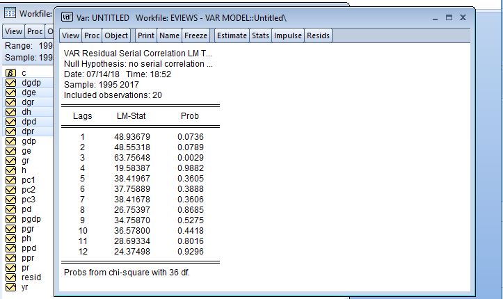

Because I read in an article that the VAR models have to meet the conditions regarding the quality of the residuals - the normal distribution (Normality test), the absence of heteroskedasticity (White heteroskedasticity test) and the lack of autocorrelation of the errors (Autocorrelation LM test).

The article is just wrong.
A VAR is just a collection of least squares regressions. Normality and heteroskedasticity matter for coefficient tests, but usually no one is interested in doing those for a VAR. Autocorrelation does matter-it's usually handled by adding lags to the VAR.

Postby Alina03 » Sat Jul 14, 2018 8:57 am
Here is my autocorrelation test. Could I choose the first lag?
Re: Near Singular Matrix Error
Postby startz » Sat Jul 14, 2018 9:24 am
This probably suggests adding one more lag to the VAR. But you have very few observations, so it's not entirely obvious whether you should.

Postby Alina03 » Sat Jul 14, 2018 10:05 am
Could I run this model with just one lag?
Postby startz » Sat Jul 14, 2018 10:15 am
Perhaps run with one lag and run with two and see if it makes any difference. The real issue is that only having 20 observations limits what you can do.
