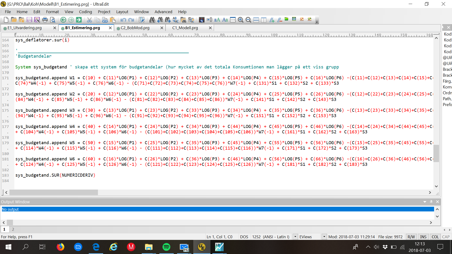

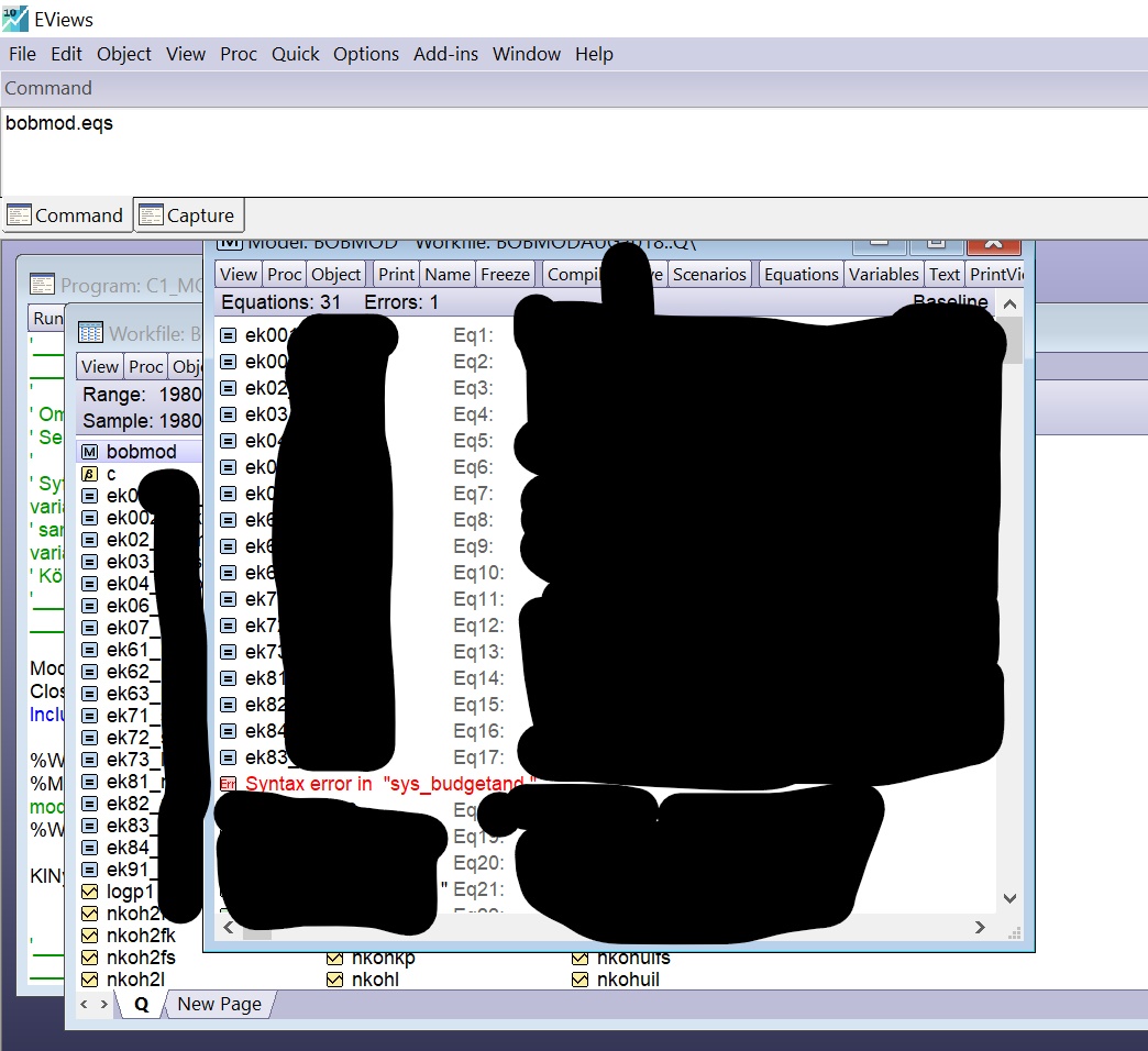

Hi Gareth,
I have tried what you suggested but it doesn't work. I attach a printscreen of my code and what I get when I run the file.
Any suggestions on what can be wrong with it?
Thank you!

Postby maianq » Wed Jul 04, 2018 12:27 am
Hi Gareth,
thanks again for your help....unfortunately that : doesnt help either. The error message I get now is "sys_budgetand is not defined in :sys_budgetand".
WHen i run the prg file where I define the system,( the program in the picture) there is no problem for the eviews to create the system. Eviews only problem is that it doesnt seem to add it to the model, where I actually need it.
Do you have other suggestions?
Thanks a lot!
E
