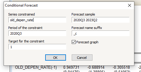

Hi dakila,
Thanks for the add-in. Is it possible for you to have an illutration for it?
I tried to use it but got error.
I assume the value or old_depen_rate at 2020Q3 is 1
error message

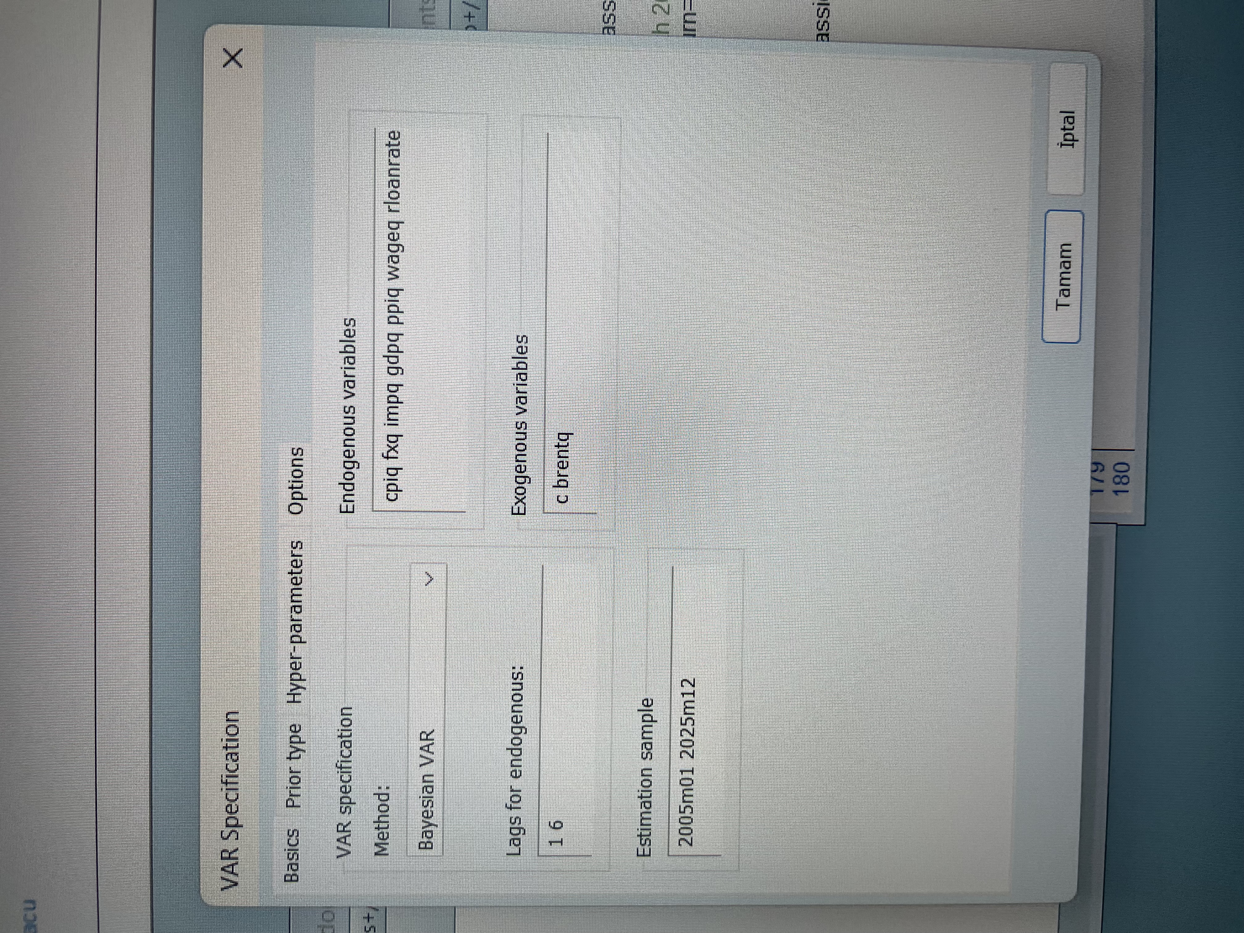

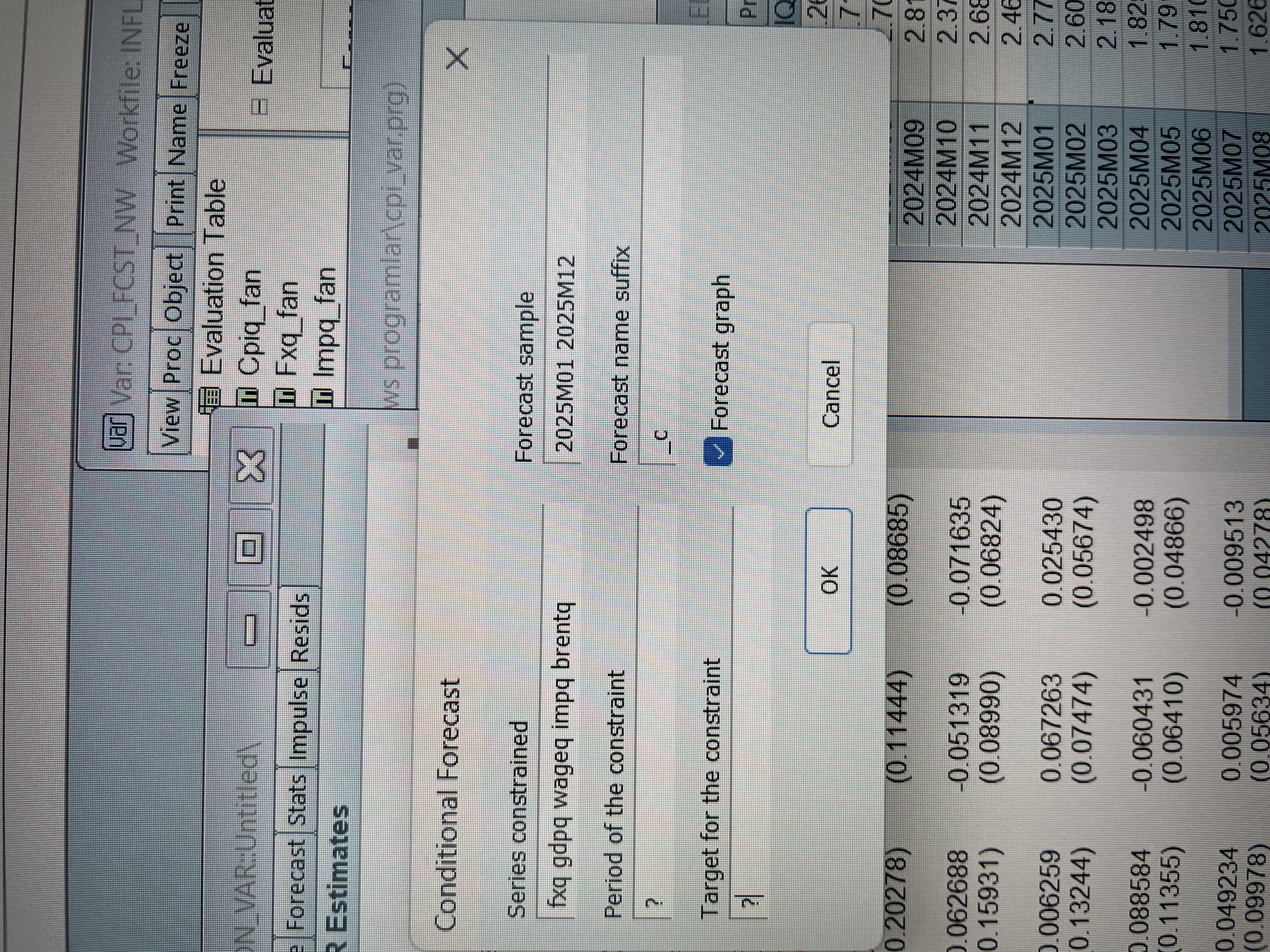

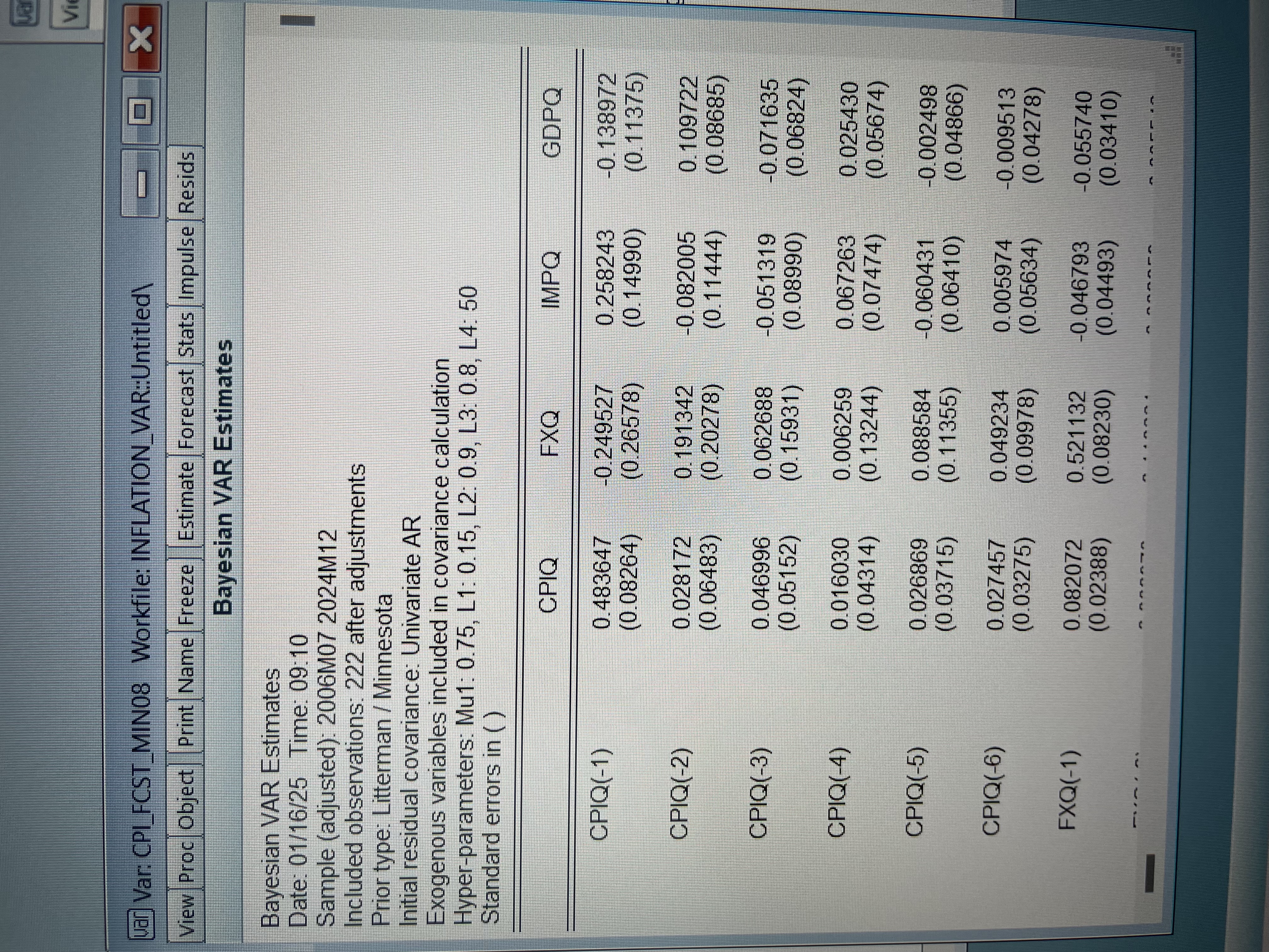

Hi all, I have a BVAR model for inflation forecasting. I would like to make some assumptions about the future paths of some variables (such as exchange rate, oil price, wages etc) and get the forecasts of inflation conditional on these values. Standard forecast tools of Eviews doesn’t help since dynamic forecasting uses model generated future values and static forecasting requires every series including inflation has the future paths. I tried to use the confcast add-in but couldn’t make it work. I’ll appreciate any help.
mrduran
Posts: 6
Joined: Wed Aug 03, 2011 6:11 am
Contact:
Re: Conditional VAR forecast
Postby mrduran » Wed Jan 15, 2025 11:15 pm
Here is my model.
