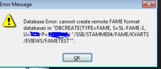

Postby tvonbrasch » Sat May 19, 2018 2:34 am
I tried to save my data into a fame database, but when using the dbcreate command, I got the following error message:
How can I save my data in a fame database?
Re: Saving to fame database
Postby EViews Gareth » Sat May 19, 2018 8:05 am
DBCREATE creates a new database. If you want to store data into an existing database, use STORE.

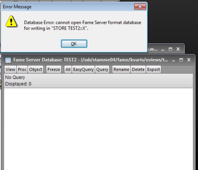

Postby tvonbrasch » Sat May 19, 2018 11:00 pm
I tried using the STORE command, but then I got the error message
and I have read and write access to this path on linux. I do not understand what is causing this... do you have an idea?

Postby EViews Jason » Mon May 21, 2018 9:18 am
I am looking into it right now but I dont believe EViews can create FAME server databases. I think EViews can create FAME local databases but that is a completely different category. I would try creating the database via the FAME application and then use dbopen and dbstore to open and save to the database.

Postby EViews Jason » Mon May 21, 2018 9:37 am
If the database does exist and you get the same error using dbopen, I would also verify your FAME license files are up to date. Can you run the FAME application and open the database?
Assuming the FAME application works, does fetching a series from the same database work?

Postby tvonbrasch » Mon May 21, 2018 11:15 pm
Hi Jason
Yes, there was a problem with how to write stuff to LINUX.
