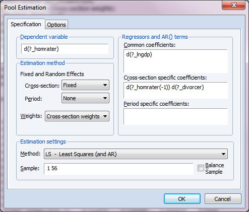

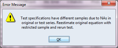

Hello. I use EViews 8. I have 40 countries for 56 years in the data. Of course, there are many missing values. I did pool estimation and tried to do the redundant variables test, but only saw the following error message:
"Test specifications have different samples due to NAs in original or test series. Reestimate original equation with restricted sample and rerun test."
Would you please let me know how to restrict the sample? I'd like to do a redundant variables test on the country-specific effects. Please refer to the attached files.
"Balance Sample" leaves no observation, thus it's not an option. The same error appears when I checked the "No d.f. correction" box. I know the command "sample" and "smpl", but I don't know what to sample.

Unless there is something strange about the data in your workfile, create a group containing
Call it something like G1. Restimate the equation with a modfied sample that excludes the observations that your unrestricted model would otherwise automatically exclude
What's going on is that your test is excluding the lagged value variable so the restricted model using the specified sample has too many observations.
d(?_homrater(-1)) Code: Select all
1 56 if @rnas(G1)=0-
