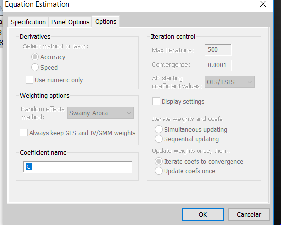

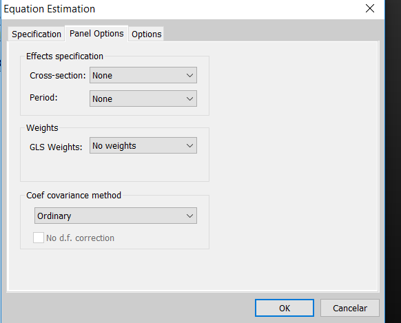

That is indeed what I want, but when I attempted the estimation I noticed there are no options for it in panel data (dated panel, more specifically; if i use unstructured data, the options are there).
Is there any reason why the options aren't available for panel data when even the example the manual uses is based on it? Is there any difference/problem in using unstructured/undated data in my analysis so I can perform said clustering?
Thank you again!
P.S.: Attached go the estimation options I get for dated panel.

The panel estimators have built-in tools which allow for clustering by cross-section or by period, but not by both. So you can cluster by firm, and you can cluster by year, but not by firm-year.
The non-panel estimators were recently updated to allow for arbitrary clustering.

The in built tools you mention for clustering by cross section or period are those under the "coef covariance method"? If not, where? And which would be more appropriate to achieve said clustering, since there are many options?

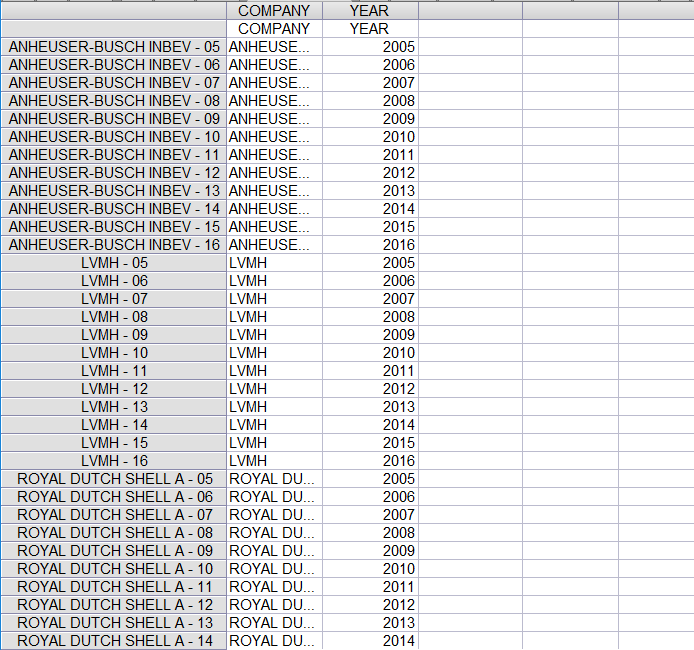

The file is structured as panel. I don't quite undertand the first part of the question, so I send a snapshot of my data attached.
Regarding estimation, I intend on maybe using individual and time fixed effects.
- Eviews.PNG (53.22 KiB) Viewed 17740 times

It looks as though you have a single observation per period/cross-section.

Alternately, the panel estimators don't have the two way clustered built-in, only the one. If all that you want is a one-way standard error, those are available from the Coef Covariance Method combo. If you want two-way, unfortunately, you'll have to work for those a bit.

I'm not sure what you mean by only one observation per firm-year (is it possible to have more than one?), but yes, each firm-year has one observation (although multiple variables).
So you're suggesting I unstructure the dated panel? I had noticed that the results look pretty much the same in both ways (unstructured vs dated panel), but is it 100% ok to do that or is there any disadvantage in having the data unstructured vs panel that I should be wary of? I have 13 years and 2600 cross sections, by the way.
From the one way estimators in the coef covariance option, is it correct that the period options are equivalent to clustering by time and cross section options equivalent to clustering by individual (firms, in my case), while accounting for heteroscedasticity and/or autocorelation at the same time? The many options leave me a bit confused even after reading the manual, so your clarifications would be very much appreciated!

On the one-way covariance estimators, the naming convention is the opposite of what you wrote. The period estimators denote clustering by individual, and the cross-section are clustering by time. The naming convention is from the old system estimation days in that it emphasizes allowing "between period correlation" and "between cross-section correlation" in the name.
