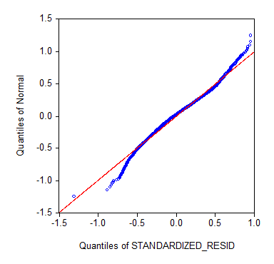

As far as I know, one of the easiest ways to make a Theoretical Quantile vs Standardized Residual plot is through the following commands:
my_equation.makeresid(s) standardized_residuals standardized_residuals.qqplot theory
That gave me something that looks like this:
qq plot 2.png (6.05 KiB) Viewed 6785 times
Note that the x axis reads "Quantiles of Standardized Residuals". Unfortunately, I have to conform to the convention of having the random quantity on the Y axis (and fixed quantity on the x axis), so I will need to switch the axes somehow. Is there an argument for that? I did not come across one in the manual.
I would also accept a solution where one saves the theoretical quantile as a separate series. If I had that, I presume I could do:
std_resid_qq_series.line
Then I could overlay the standardized residuals as dots.
Re: Switching QQ Plot Axes, Generate New Series
Postby EViews Gareth » Mon Oct 16, 2017 8:31 am
Freeze it to a graph, then use graph.setelem axis to change the axis they are on.

Just for robustness, is there also a way to achieve the latter of my ideas? Generating a new series that contains the theoretical quantile so that I may include it for general purpose graphing? I know there is a make distdata command, but it returns a matrix and it seems to be slightly different than what I have in my graphs as pictured in my original post.
