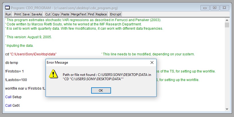

That's right! I meant the error after running the program. The path seems to be not found, even though the data are in excel format. I even prepared the data in Eviews database format, nevertheless, still getting the same message!

Re: Help required with a program on simulation!
Postby EViews Gareth » Tue Sep 05, 2017 9:47 am
Do you have a folder called "c:\users\sony\desktop\data" on your computer?

Postby Amiro » Thu Sep 07, 2017 2:02 am
The data file in on the desktop called "data"
Postby EViews Gareth » Thu Sep 07, 2017 5:37 am
In a folder called data?

Postby Amiro » Thu Sep 07, 2017 11:41 pm
No, the file is called data. But I'm guessing, I should try to enter only the folder path!
Postby EViews Matt » Fri Sep 08, 2017 8:42 am
If you look a little further down the program, it ultimately attempts to read files "data\XXX_1.txt" and "data\XXXdebt.txt", which are relative to the path you specify in the cd statement. If that's not how your data is organized, you'll need to either change your data or change the program.
