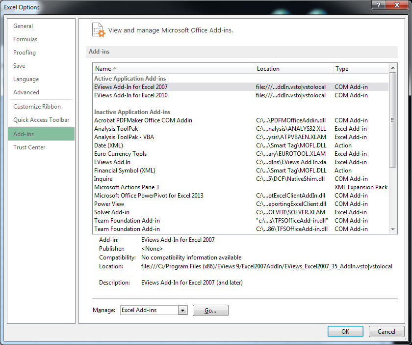

You can actually see the location of where each of your Excel add-ins are running from by going to the Excel File menu/Options/Add-Ins, then looking at the Location column (or label below):

5. Now run Excel. Go to File/Options/Add-Ins, then select "COM Add-ins" in the Manage dropdown, then click Go.
6. If you see multiple versions of the EViews Add-In for Excel, make sure only the one that came from the version of EViews you just ran REGCOMPONENTS on is checked. You can see the file path for each add-in by highlighting the row and looking at the "Location:" label below. Click OK to save the changes, if any.
