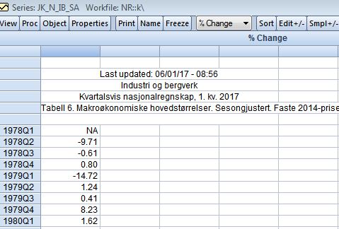

Is there a way to change the view of a series to one decimal place when looking at say %change?
As it is now, the window shows two decimal places when looking at % Change. I know I can use the @pc command to get the full number of decimals, but it would be convenient if one could adjust this also in the spreadsheet view of a series.

Properties.

excellent, thanks,
but is there a way to change this setting for all the series in a workfile?
Re: Spreadsheet view: decimal places
Postby EViews Gareth » Tue Jun 06, 2017 7:55 am
Not on a per workfile basis. There's just per series or global.
