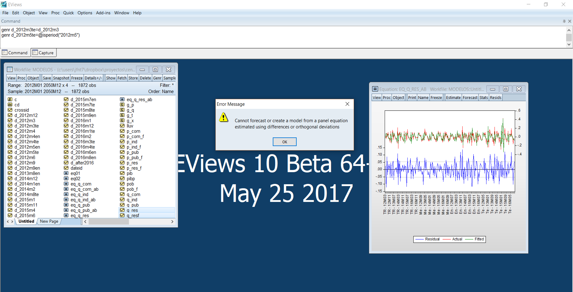

Please I need help....
This is the message that show me Eviews:
"Can not estimate or create a model from a panel equation estimated using differences or orthogonal deviations"
Could you tell me how I can forecast whit this model?
Thanks,
Francisco

Yes I did, but this message appears when I click the forecast button in the menu of the equation model.

In the attachment I share an image of the problem
Re: Problem with Dynamic Panel Data Forecast
Postby EViews Gareth » Thu Jun 01, 2017 10:51 am
The error message is somewhat self explanatory - EViews will not forecast from equations estimated with difference or orthogonal deviation cross-section effects specified.

Yes, EVIEWS can not generate forecasts by pushing a button. But I have already developed a program in EVIEWS to generate this forecasts using the equation object of the equation of the dynamic panel. As long as EVIEWS does not add this functionality I will continue to use my program.
