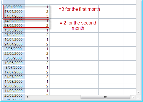

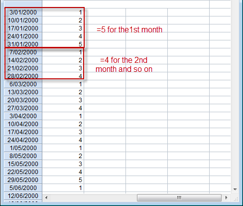

4) could i make two series (frequency monthly) contained the number of weeks and fortnight?
forthnight in month.png (18.76 KiB) Viewed 17196 times
week in month.png (19.41 KiB) Viewed 17196 times

2/ and for my question about weeks and forthnight?

for my question about weeks and fortnight, there is no solution.
how can transfer the every last obs of week in month and date corresponding in the month from page freq weekly to the page monthly freq.
series date_lastw, series obs_lastw
