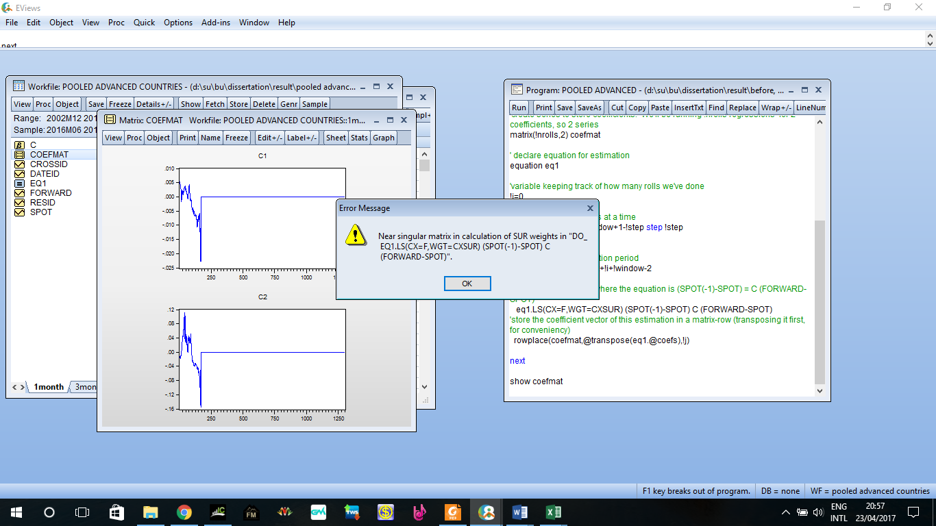

In my dissertation, I want to apply the rolling coefficient for 5-year window (my data is monthly so window size = 60), and step size = 1. Could someone please help me how can i perform the test for pooled panel data (consist of 8 countries) using fixed effect and GLS weight method is Cross section SUR. I am really grateful for any advice since I have such limited experience on Eviews and the deadline is near. Many thanks for your help.
Re: Basic Rolling Regression
What exactly are you looking for? Forecasts? Or just repeated GLS estimations?
It would be easier if you could provide the code you have written so far (or look for a example of a code in this forum).

This is my code so far, but when I press enter, a notification pops up "COEFMAT is not defined". What should I do in this situation? By the way, I want to show the rolling graph for my coefficent as well, what should I add in my code? Thank you.
'run rolling regression
' set window size
!window = 60
' set step size
!step = 1
' get size of workfile
!length = @obsrange
' declare equation for estimation
equation eq1
'calculate number of rolls
!nrolls = @round((!length-!window)/!step)
'matrix to store coefficient estimates
matrix(3,!nrolls) coefmat ' where 3 is the number of coefficients
'variable keeping track of how many rolls we've done
!j=0
' move sample !step obs at a time
for !i = 1 to !length-!window+1-!step step !step
!j=!j+1
' set sample to estimation period
smpl @first+!i-1 @first+!i+!window-2
' estimate equation - where the equation is (SPOT(-1)-SPOT) = C (FORWARD-SPOT)
eq1.LS(WGT=CXSUR) (SPOT(-1)-SPOT) C (FORWARD-SPOT)
'store coefficients
colplace(coefmat,eq1.@coefs,!j)
next
show coefmatRe: Basic Rolling Regression
You should set the "3" in the part that reads:
to the actual number of coefficients you estimate in your equation "eq1.LS(WGT=CXSUR) (SPOT(-1)-SPOT) C (FORWARD-SPOT)"
By the looks of it, it should be 2.
matrix(3,!nrolls) coefmat ' where 3 is the number of coefficientsBy the looks of it, it should be 2.
Alice Thai
- Posts: 6
- Joined: Fri Apr 21, 2017 6:28 am
Thank you The Yoyo for the correction. However, when I press enter the code line !nrolls = @round((!length-!window)/!step) a message "!STEP is not defined". But i have defined !step = 1 on the above code. How can I solve this problem? Thank you so much.You should set the "3" in the part that reads:
to the actual number of coefficients you estimate in your equation "eq1.LS(WGT=CXSUR) (SPOT(-1)-SPOT) C (FORWARD-SPOT)"Code: Select all
'matrix to store coefficient estimates matrix(3,!nrolls) coefmat ' where 3 is the number of coefficients
Are you running the entire script as a program? (File>New>Program)? Don't run the code line by line in the top view bar.
(Or similary, running:)
' set window size
!window = 60
' set step size
!step = 1
!length = @obsrange
!nrolls = @floor((!length-!window)/!step)
'create series to store coefficients. We'll be running !nrolls regressions for 2 coefficients, so 2 series
matrix(!nrolls,2) coefmat
equation eq1
!j=0
!j=!j+1
eq1.LS (SPOT(-1)-SPOT) C (FORWARD-SPOT)
'store the coefficient vector of this estimation in a matrix-row (transposing it first, for conveniency)
rowplace(coefmat,@transpose(eq1.@coefs),!i)
next
show coefmat-
Alice Thai
- Posts: 6
Dear The Yoyo, thank you so much, I am making progress on this, I have successfully created the rolling window. However, another problem arises since the result only displays around 250 observations (I have attached an image for the issue, I think this could be my data is pooled panel data so the program can only run smoothly for the 170 observations of the first country.). In addition, I want to estimate the change of the coefficients over the time series, so is there any way to display the year on the x-axis instead of the observations? Thank you for your help.
- problem.png (120.94 KiB) Viewed 384940 times
