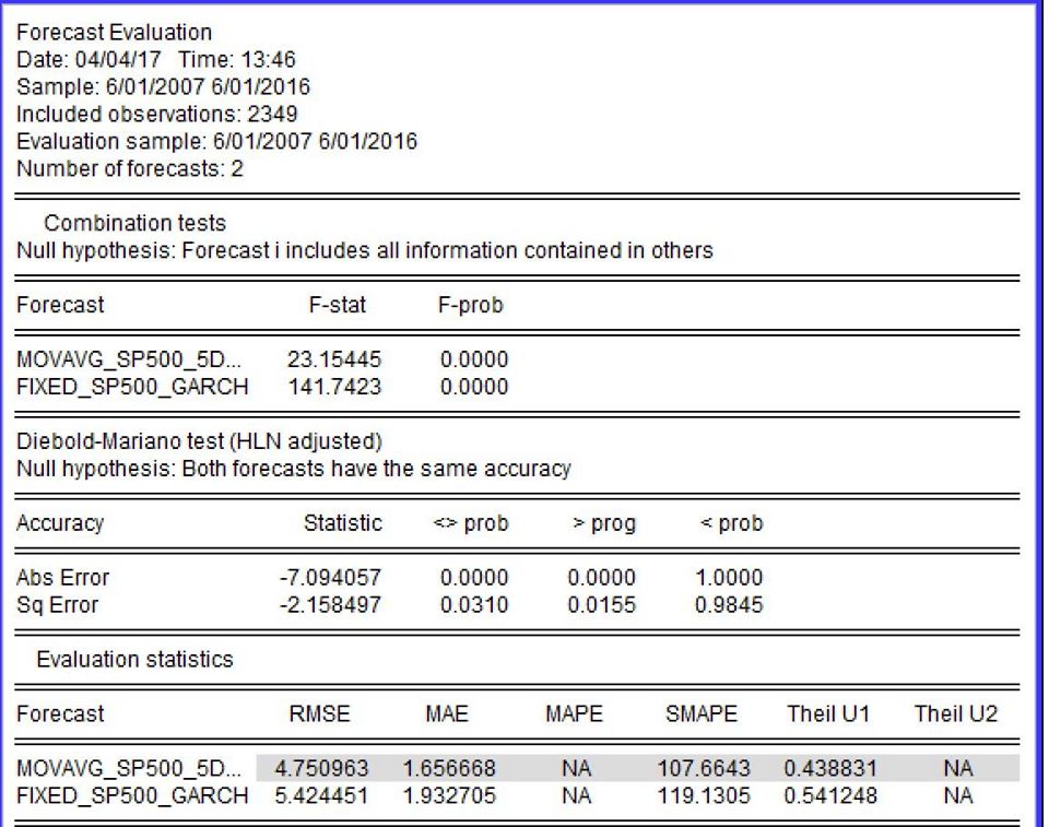

Just a quick question again, what do <>prob, >prog and <prob actually stand for in this case? How does one interpret the test?The add-in was available before the built in. There is no reason to use the add-in now.
I am aware how the test works, how to interpret the t-test, just wondering what the above are for.
- 17758316_10154823523108141_4740627384852321956_o.jpg (105.25 KiB) Viewed 44531 times
- Posts: 13612
Re: DMtest - Diebold-Mariano Forecast Evaluation Test
Probabilities of the alternative hypotheses (that forecast 1 differs in accuracy from forecast 2, forecast 1 is less accurate, forecast 2 is more accurate).
