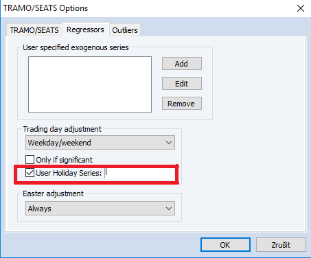

I have retail trade time series and I want to make a seasonal adjustment by TRAMO/SEATS in EViews. The problem is that I need to use "User Holiday Series"to let EViews know when the holidays are held in our country. I would like to ask how the format of these user holiday series should look like (to import it in EViews). I cannot find it anywhere. I use monthly data but I think the best way would be to construct daily holiday series with fixed days marked as holidays (New Year, 1st May, Christmas, etc.). Is it possible to solve this issue?

It is a series of integers denoting how many days of holiday there are in each observation (month/quarter).
