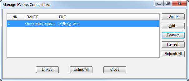

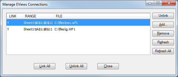

How are you removing the connection? Are you using our add-in Manage Connections window? If so, are you highlighting just the one connection and clicking the Remove button? I just tested this in EViews 9 and that window only removes the selected connection and leaves the others behind.
Before clicking Remove:
After clicking Remove:

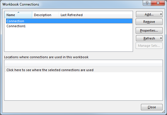

Or did you try removing the connection from the Workbook Connections dialog? (you can display this by clicking on the Data tab and clicking on the Connections button). That also only removes the single connection you have selected when you click on Remove.
