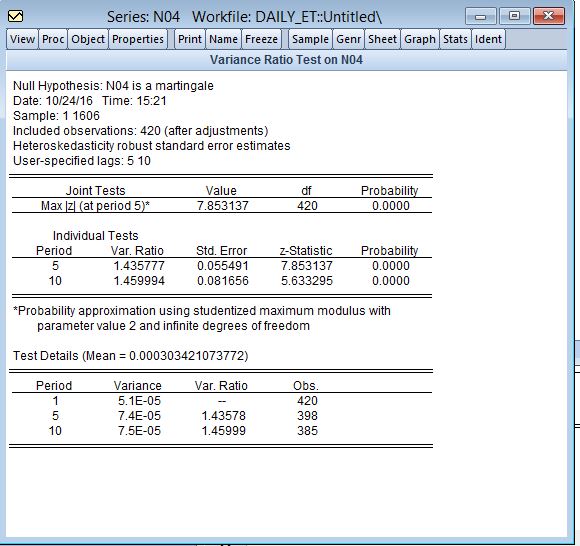

Now here is the question: I set the "user-specified list or vector" to be 1 5 10 to try to match the above quote. However I get an error message when trying to run the test (along the lines of "must be a set of unique integer values greater than one").
Question 1: Why can't I set it to include one? e.g. 1 5 10
Question 2: Maybe 1 is included automatically? I notice if I run the VR test using 5 and 10 only that in the test details section of the output the period 1 is included but it is not in the "individuals tests" part... (screenshot attached).

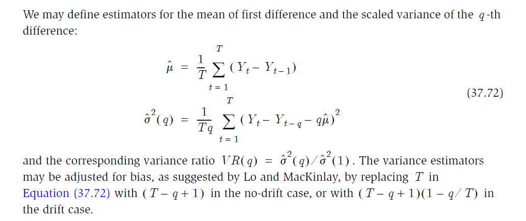

Postby EViews Gareth » Mon Oct 24, 2016 3:51 pm
From the EViews documentation:
How do you take the ratio of 1 and q=1?

Postby confusedguy » Mon Oct 24, 2016 4:08 pm
Ah... point taken! Guilty of not engaging brain.
