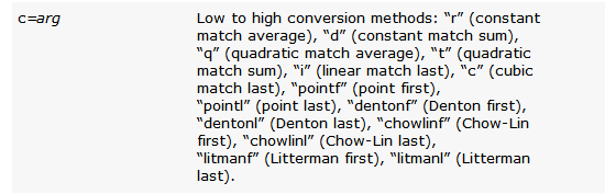

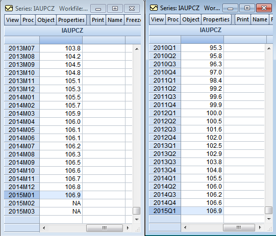

I was pleased to hear that with EViews 9 support was said to be added for interpolation that allowed matches to "first" to complement the existing "last" option for cubic spline
However, I cannot see the option available in the copy command documentation, and when I use "last" now it seems to produce an interpolation based upon "first". If I use EViews 8 I get the correct lineup.
e.g.
copy(c=c) QCPI\iaupcz real\iaupcz
as per attachments.
It would be great if both options could be made to work for cubic spline
Graham

This was actually fixed in the April 27 patch (released 2 days ago). Please update to that version and let me know if it works for you...

Not sure how we missed this in our documentation, but here's the info you asked for:
For cubic spline match first, use the following:
c=cubicf
For cubic spline match last, you can use either
c=cubicl
or
c=c
I'll notify our documentation team about the missing info.
