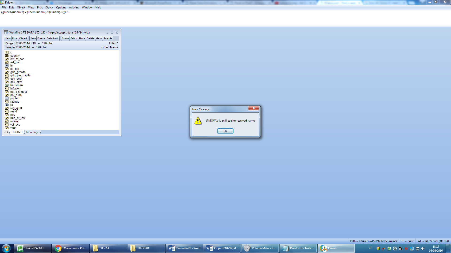

I am trying to do the moving average but this message shows up :
@MOVAV is an illegal or reserved name.
Why is this happening?

I copy pasted the formula mentioned and this is what I get the attached.
Thanks,
Angie

But why do I get that error message
Re: moving average
Postby EViews Gareth » Tue Aug 16, 2016 11:38 am
Because you aren't including it as a regressor. There's no equation to be seen.
