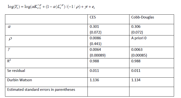

I tried but still R2 is not getting a value that should be. I have uploaded the work file. The equation need to estimated is like this
log(GDP)=log(a*Capital^-p+(1-a)*Labour^-p)/(-1/p)+yt+e
It is a log written version of ces production function. Capital is with t-1. I will put the picture of the equation as well.

This is the picture from a paper.

I don't think you've done anything wrong. The solution is highly sensitive to the starting values. For example, if you add in the trend term and start at c=1, you get a perfectly nice estimate...it just isn't the same estimate as in the picture.Getting a reliable nonlinear estimate with only 24 observations is tough. Sometimes there's nothing to do but stat estimates at lots of different values and see which one is best. Alternatively, one can plot the likelihood..but EViews isn't the right software for that.
