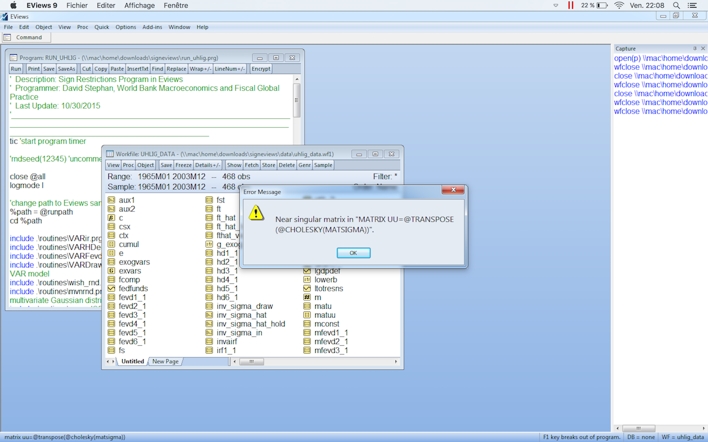

Hello, I tried to run the run_uhlig.prg proposed by macroWB just above (thank you for sharing!), but got an error message warring about a near singular matrix. But several colleagues of mine tried it as well, and some of them faced the same problem, but others did not have any problem. We use the same EViews 9 version. Where could that come from?
Capture d’écran 2016-04-29 à 22.08.53 - copie.png (630.13 KiB) Viewed 7970 times
