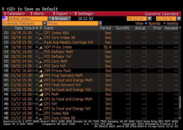

I also get the dates until February 2016. However, future dates seems to be available until November 2016:
CPI NSA future release dates
