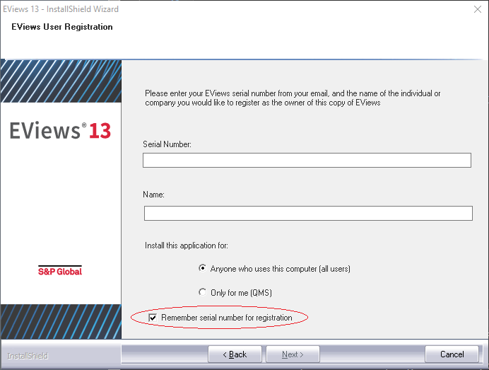

Typically, our installers ask for an EViews serial number during installation in order to know how to setup EViews licensing properly on the target machine. This means that this serial number will be "recorded" into the installer script if you are in record mode. This is ideal for those of you that purchased a concurrent or an unlimited lab license because all of your users will share the single serial number (typically registered on a local EViews License server).
However, for standalone license users where each user has a different serial number, doing a silent install requires a few more steps. When EViews runs for the first time after an install, if a standalone license was entered during the installation, EViews will automatically pre-fill this serial number into the Registration dialog that appears. This is done for convenience so that our typical user does not have enter the serial number twice. But if you wish to perform multiple silent installs each with a different serial number, you will want to prevent EViews from remembering the serial number entered during installation. To do this, we provide a special checkbox on the installer dialog that asks for the serial number:
(this checkbox only appears when the installer is running in RECORD mode)
During the recording, make sure to UNCHECK this checkbox and proceed with the installation. Now when EViews is run for the first time on the target machine, it will not pre-fill in the serial number on the Registration dialog. This requires the user to manually enter his/her own serial number, which you can provide via an email or however you wish.

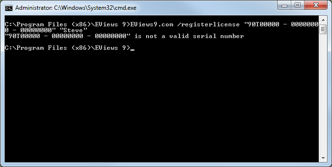

I tried to follow your instructions and I'm able to install Eviews 9 silently, but your command line switch /registerlicense doesn't work for me. It keeps giving me an error saying invalid switch. I tried running the switch using the .com file and the .exe file. Any suggestions to make this work?
Re: Silent Installation and Silent Registration
Postby EViews Steve » Thu Dec 03, 2015 8:50 am
I should've mentioned that the registerlicense switch was only added to EViews 8 & 9. It won't work for EViews 7 and older.
Here's a screenshot of what the command looks like when I run it:
(obviously, you'll have to provide your actual serial number here)
If you still have issues, send me an email (steve@eviews.com) and provide the following:
