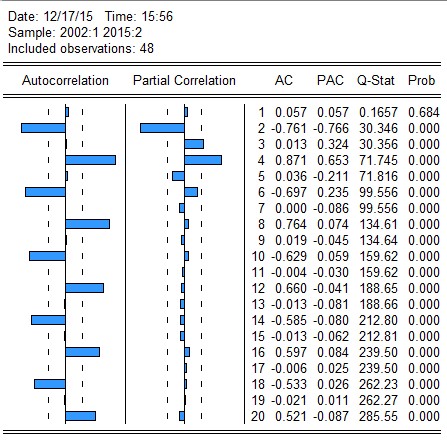

I trying to apply ARIMA model on quarterly data of 13 Years (52 data points).
I have attached the results.

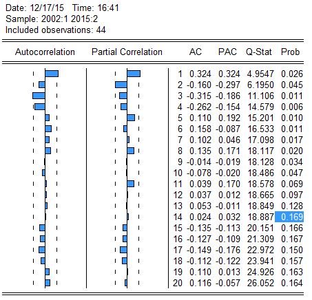

I found that data is stationary and there is a seasonality of 4. I applied the correlogram on d(y,0,4). I was successful in eliminating seasonality but the ACF and PCF are cutting off early. I'm unable to proceed further. What can be done to apply ARIMA model on this data?
Book1.xlsx
Data
(8.58 KiB) Downloaded 329 times
Correlogram of Original Data
Corrlegram of original data.jpg (86.68 KiB) Viewed 2993 times
Correlogram of Deseasonalised data
Correlogram of deseasonalised data.JPG (58.93 KiB) Viewed 2993 times
