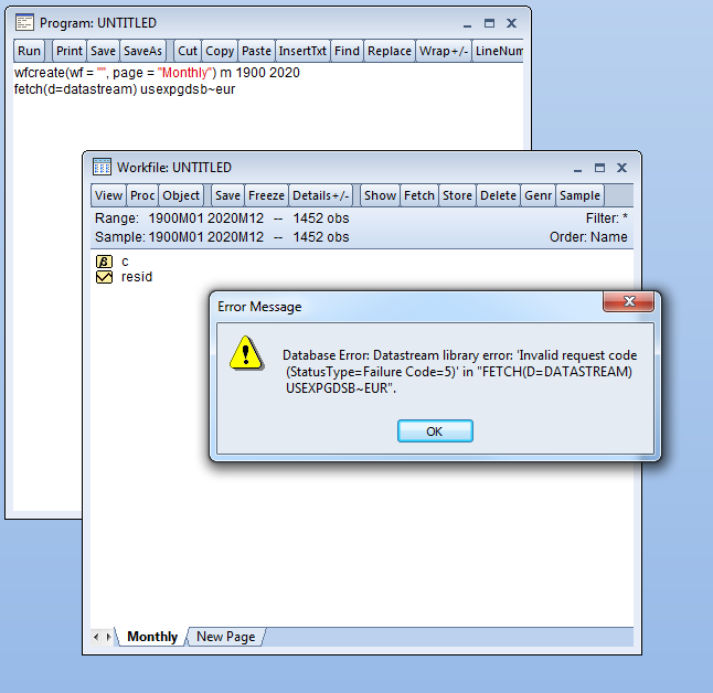

We just changed over from fetching data trhough Datastream's Zappy server to their Dataworks server and noticed that some fetching functions no longer work. In particular I used to be able to fetch U.S. exports for instance (USEXPGDSB) in euros by typing: fetch(d=datastream) USEXPGDSB~EUR. Since switching to the Dataworks server I am getting the following error (screen shot attached). Is there a different syntax to fetch in different currencies?
On a side note, Datastream tells me they are unwilling to help me with this problem.
Re: Fetching Datastream Data Denoted in Various Currencies
Postby EViews Jason » Thu Nov 19, 2015 3:05 pm
That is a syntax question for Thomson.
EViews basically passes the mnemonic and any modifiers (in this case USEXPGDSB~EUR) directly to their servers.
To prove it is not an EViews problem, go to http://europe.dataworks.thomson.com/dat ... fault.aspx. Next enter your username and password, set Source to datastream, then set Instrument to USEXPGDSB~EUR (make sure this is in all caps) and press start, you will get the same "Invalid request code, Failure=5" error.
On the other hand, if you change USEXPGDSB~EUR to USEXPGDSB, you get data. They will have to tell you the proper syntax.

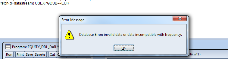

KUN0
Posts: 51
Postby KUN0 » Tue Nov 24, 2015 11:52 am
Grrr......
