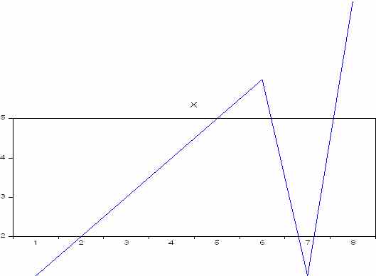

wfcreate u 8 genr x = @obsid x(7) = 1 freeze(gf) x.line gf.axis range(2,5) gf.save(t=wmf) gf.wmf gf.save(t=emf) gf.emf
for the save wmf file, the graph was not cropped, the lines go out of the frame.
gf.wmf.7z
wmf file
(559 Bytes) Downloaded 2380 times
jpg version of wmf
screen capture of emf to jpg
Re: save wmf file, unexpected result
Postby EViews Jason » Mon Nov 23, 2015 4:20 pm
That is actually correct. The successor to wmf files, emf files support clipping.
