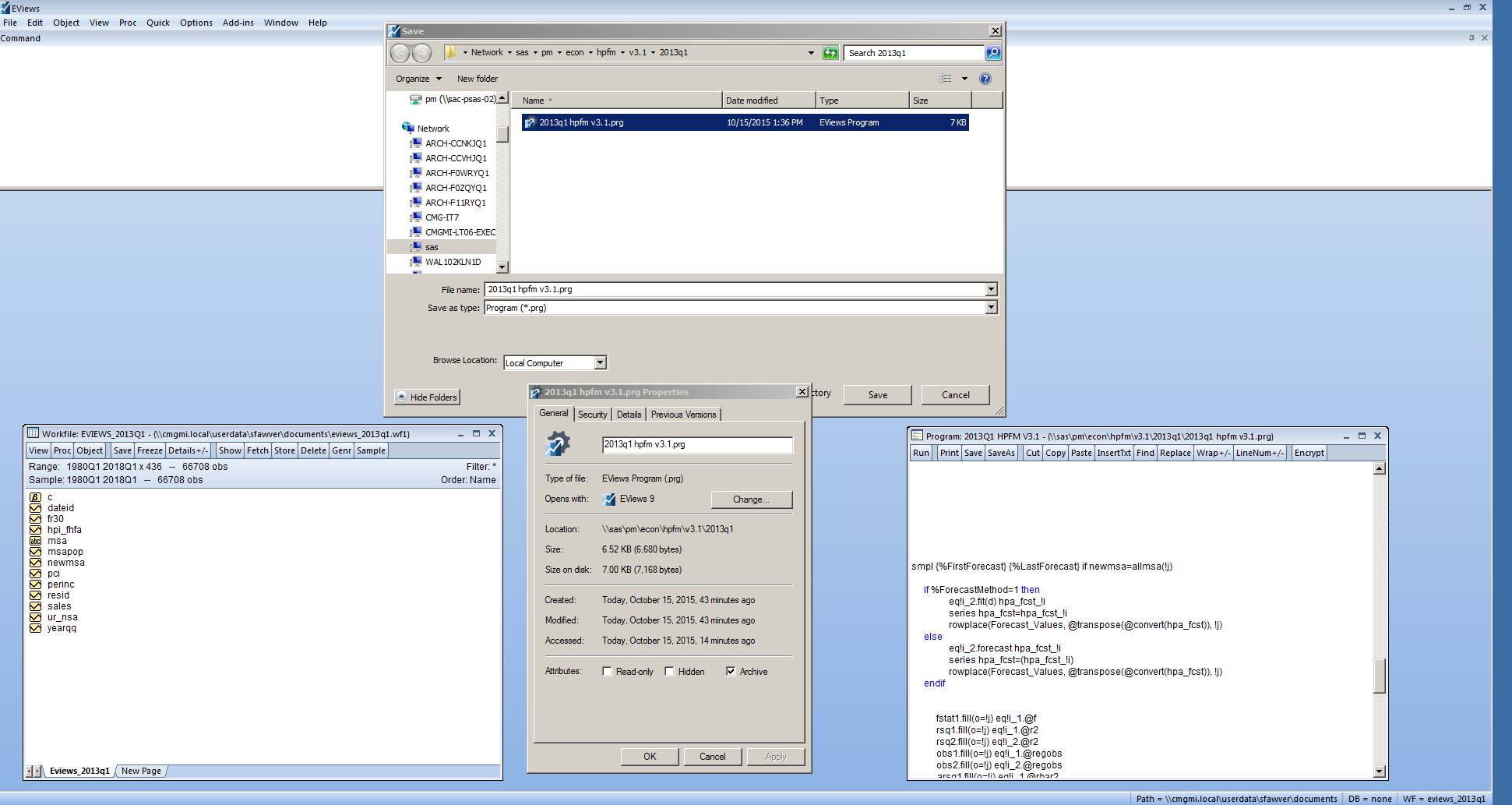

I'm able to copy and paste a Eviews program from a Linux server (using Samba) into Eviews which is running on my desktop pc. When I try to save the program I'm getting the follwing error in an error message popup.
Unable to open file \\sas\pm\econ\hpfm\v3.1\2015q2\2015q2 hpfm v3.1.prg.

Really weird, when I do a save as opens up the correct directory, it just won't save it. Attached are a couple of screenshots.
