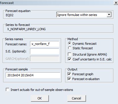

I am unable to create a simple one-step ahead forecast in a standard OLS model (eq01) and with ar/ma terms (eq02).
With the following fc settings:
My serial number is 90C05629 and running Eviews 9 on May 7 2015 build
Best regards

Postby startz » Fri May 08, 2015 6:21 am
I am very curious about where the variable SIGMASQ is coming from.

Postby rousing » Fri May 08, 2015 7:02 am
I think it is autimatically added when doing arma terms with maximum likelihood in Eviews 9

BTW, I couldn't get your equation to forecast either.
Re: forecast bug simple equation
Postby EViews Gareth » Fri May 08, 2015 10:11 am
Our mistake. New patch is out to fix it.
