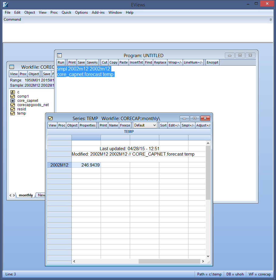

Posts: 13612
Re: fit command when equation contains @pc
Postby EViews Gareth » Tue Apr 28, 2015 11:52 am
What's the build date of your copy of 9? It works for me just fine in mine.
leah
Posts: 35
Joined: Tue Jul 16, 2013 2:29 pm
Postby leah » Tue Apr 28, 2015 12:06 pm
April 27th. It works when the sample is set to 2002m12 2002m12?
Posts: 13612
Postby EViews Gareth » Tue Apr 28, 2015 12:55 pm
Yep.
