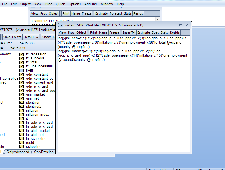

Could I include @expand(country ,@dropfirst) in my SUR system to create cross section dummies and something similar for period effect? If yes, would it look like in the attachment? How could I do similar dummies for period effects.
thanks for the fast replies :D
- Capture.PNG (46.29 KiB) Viewed 6554 times
- Posts: 13604
Re: SUR or Fixed Effects Reg. unbalanced panel
You cannot. You'll have to add them manually.
