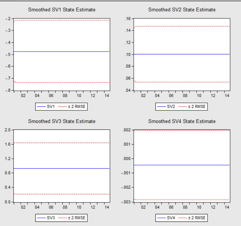

To be more specific, here is the result I got from the following model.
@signal X = sv1*A + sv2*B + sv3*C + sv4*D + [var = exp(c(1))]
@state sv1 = sv1(-1)
@state sv2 = sv2(-1)
@state sv3 = sv3(-1)
@state sv4 = sv4(-1)
Do you have any suggestion since the results look not correct in my opinion.

To be more specific, here is the result I got from the following model.@signal X = sv1*A + sv2*B + sv3*C + sv4*D + [var = exp(c(1))]@state sv1 = sv1(-1)@state sv2 = sv2(-1)@state sv3 = sv3(-1)@state sv4 = sv4(-1)Do you have any suggestion since the results look not correct in my opinion.
There is nothing wrong with the model. It is simply a fixed parameter model and is no different than its OLS counterpart:

Of course it will change the results, as you are now estimating a completely different model. In this one, you allow parameters change over time. If they are in fact time invariant, then the estimation results will produce very high negative values for coefficients c(2), c(3), c(4) and c(5) forcing the variance to zero. And it may also lead to convergence problems.
