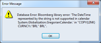

When importing data from Bloomberg, I occasionally get the following sort of error:
"Database Error: Bloomberg library error: 'The DateTime represented by the string is not supported in calendar System.Globalization.GregorianCalendar.' in "COPY(LINK) CURNCY::"KRW" KRW."
This happesn for eg KRW, BRL, and CLP, but not other currencies like CNY, EUR, JPY, MXN, etc. The page freq is d5. Has anybody else seen this error?
Thanks, and happy holidays!
bbg calendar error.png (14.48 KiB) Viewed 6599 times

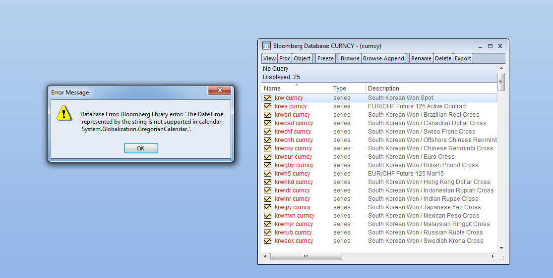

it is quite odd, because I get the same error when I drill down into the Bloomberg database via the browse function
it also refuses to download in any frequency of workfile
