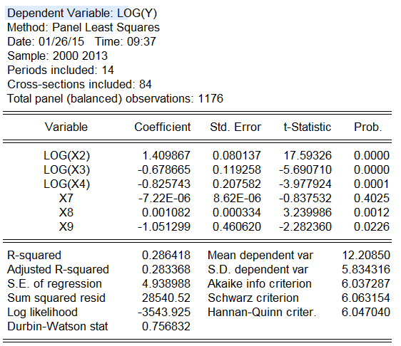

Re: insurficient number of observations problem
Postby startz » Mon Jan 26, 2015 10:38 am
Is this what you did?
newtoeviews
Posts: 7
Joined: Fri Jan 23, 2015 8:51 am
Postby newtoeviews » Mon Jan 26, 2015 10:45 am
There is perhaps some problem of my eviews because I still can not get it. But thank you so much. I know now my data is all correct.
