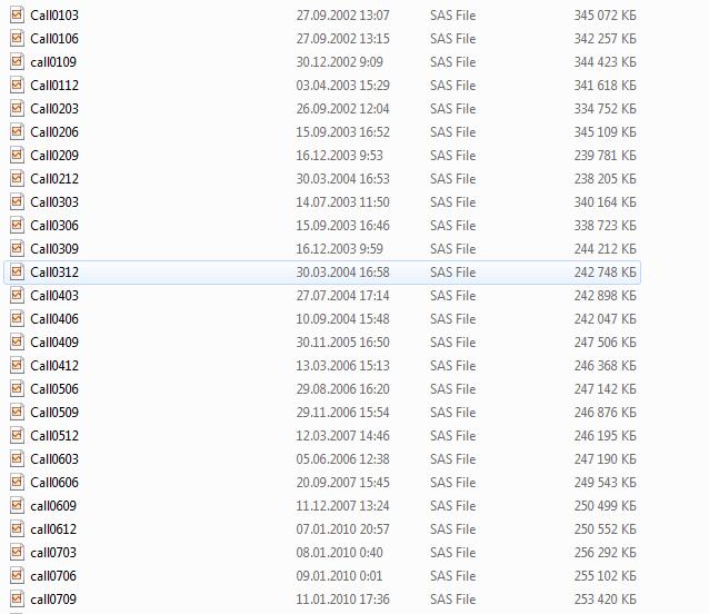

My data is splitted into many parts and I want to put them together by using an Eviews program. You can see the list of the names of the data files. I tried to use the following command:
for !i=01 to 10
for !j=03 to 12
pageload "D:\data\Call{!i}{!j}.xpt"
next
next
However, it didnot work. Could you please provide a command for that?Thanks in advance.
Sam

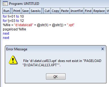

Re: Creating loop for loading pages
Thanks Gareth for the help.
However, I got an error shown in the attachment. I think eviews reads "01" as "1" thus instead of "Call0103" eviews tries to find "Call13".
Please help.
Thanks in advance,
Sam
Please help.
Thanks in advance,
Sam
- 11.jpg (20.95 KiB) Viewed 6510 times
- Posts: 13605
for !i=01 to 10
for !j=03 to 12
%i = @str(!i, "i02")
%j = @str(!j, "i02")
%file = "d:\data\call" + %i + %j + ".xpt"
pageload %file
next
next
