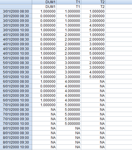

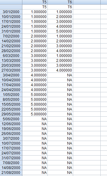

question: generate trend and dummy for different frequency.
1-interday:
genr trend (t1): from 03/01/2000 08:00 to 03/01/2000 10:00 take 1
from 04/01/2000 08:00 to 04/01/2000 10:00 take 2. and so on
genr trend (2): from 03/01/2000 08:00 to 03/01/2000 10:00 take 1 2 3 4 5.
from 04/01/2000 08:00 to 04/01/2000 10:00 take 1 2 3 4 5. and son on
genr dum1: the first 03/01/2000 08:00 and the last 03/01/2000 10:00 take 1
the first 04/01/20000 08:00 and the last 04/01/2000 10:00 take 1. and so on

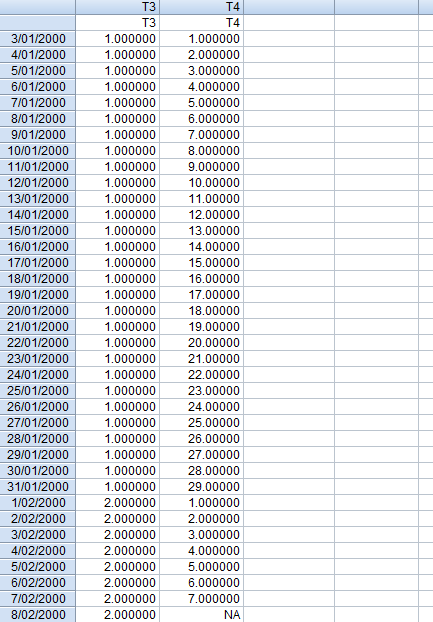

2-daily
genr trend (t3): the first month take 1, the second month take 2, the third month take 3...etc
genr trend (t4): the first month take 1 2 3...29, the second month take 1 2 3...29, the third month take 1 2 3...31,...and son on
3-weekday
genr trend (t5): the first month take 1 next month take 2 and so on
genr trend (t6): the first month take 1 2 3...5, the second month take 1...4, and son on.

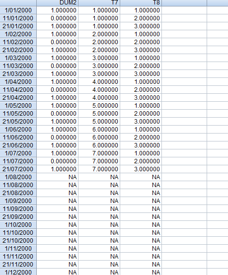

4-tenday
genr trend (t7): the first month take 1 next month take 2 and so on
genr trend (t8): the first month take 1 2 3 next month take 1 2 3 and so on
genr dum2: the first tenday and the last take 1 for every month.

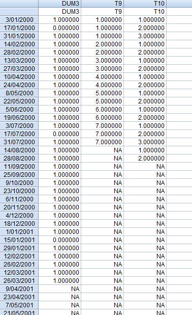

5-fortnight
genr trend (t9): the first month take 1 next month take 2 and so on
genr trend (t10): the first month take 1 2 3 next month take 1 2 and so on
genr dum3: the first and last fortnight take 1 for every months.
1-interday:
2-daily

4-tenday
5-fortnight

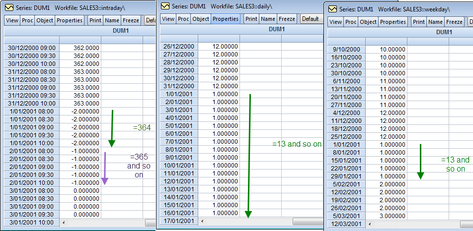

Re: generate trend for dummy

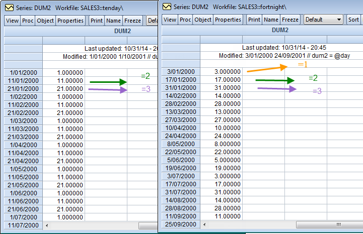

problem
1-inraday:
the code for dum1 generate trend for the first year, it not continue for the second year 2001 it repeat.
2-daily:
same problem for the code dum1 (and same problem for fortnight & tenday)
3-weekday:
A- same problem for the code dum1 (and same problem for fortnight & tenday)
B- when i une the code for dum2 it chow error message '' dum is not defined "
4- when i use the code for dum2 (tenday & fortnight) it not generate trend for example: frequency tenday
11/01/2000 take 11 it should equal 2.
21/01/2000 take 21 it should equal 3.
1-inraday:
series dum1 = @datepart(@date, "ddd")-3 same problem for the code dum1 (and same problem for fortnight & tenday)
series dum1=@monthA- same problem for the code dum1 (and same problem for fortnight & tenday)
series dum1=@monthCode: Select all
series dum2= @recode(@month<>@month(-1), 1, dum(-1)+1)11/01/2000 take 11 it should equal 2.
series dum2 = @day- Attachments
- dum2222.png (55.6 KiB) Viewed 9430 times
- dum11111.png (81.43 KiB) Viewed 9430 times

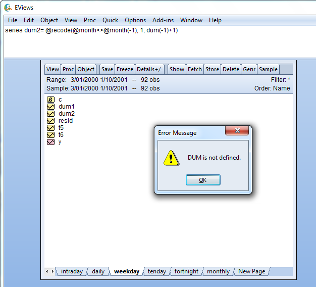

thanks a lot,
this code for dummy chow error message
what can i do.
series dum2= @recode(@month<>@month(-1), 1, dum(-1)+1)- Attachments
- dummy2.png (37.35 KiB) Viewed 9394 times
series dum2= @recode(@month<>@month(-1), 1, dum2(-1)+1)
