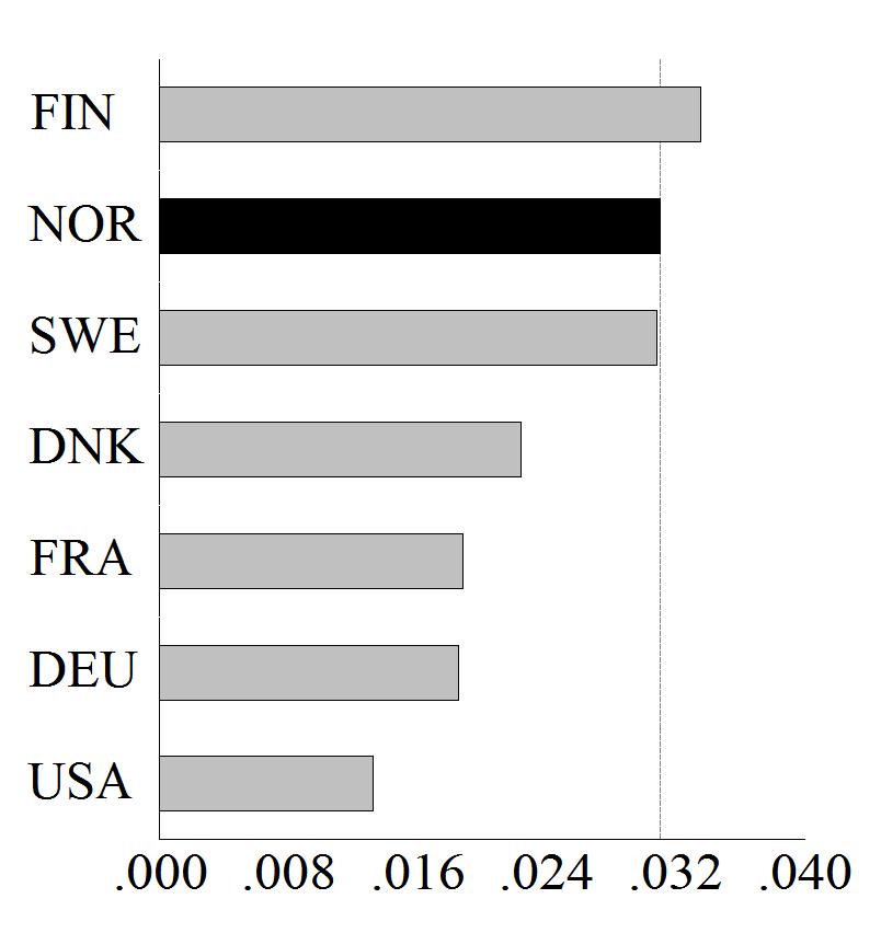

you are correct. now, when i merge the graphs, i merge them according to their value:
Re: Eviews stops working when sorting series in graph
Postby EViews Jason » Thu Oct 23, 2014 2:21 pm
The order of the series in the graph depends upon the order in which they are placed in to the group from which the graph was made. This cannot be changed. We'll investigate ways we could make sorting the series order of a group easier
